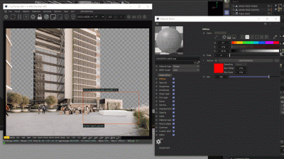

Kalua wrote:
SSmolak wrote:After changing LV camera behavior Octane stopped updating materials - if new polygons are included or excluded from material tag or new material is added to objects. There is need LV restart to update them.
I have noticed Camera movement has started to not update in LV window in some cases: when I am using "Takes", and I copy the set camera and keep using the Take set camera, I need to change the set camera and back to make it responsive in the Liveview window.
I may make a video if it sounds too confusing to understand.
Otherwise R4 is working great!
Regards,
This is the kind of behavior it has been happening lately (with or without use of "Takes"). Not updating camera and shaders mainly:
Regards,
