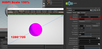

HiDPI Scaling must be supported, such as Octane for Houdini and Blender.

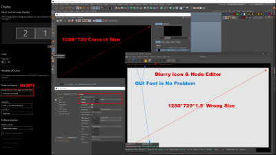

In R20 (which is not optimized for HiDPI displays), Octane is tiny. In R21, which finally supports HiDPI, Octane is just upscaled and therefore looks blurry compared to the rest of the UI. Redshift for instance is sharp, so there must be a solution i guess?

HiDPI Scaling is no problem in other applications. Please test on 4K(UHD) Monitor(not QHD Monitor).

LV is not a wrong size, you're seeing it wrong because of windows scaling. When you SAVE it from LV you'll find that's CORRECT. PV is making some down-scaling to correct it to the expected visible size. But in reality, it's not a correct size for real pixels. It's the same as monitors do with srgb color correction.
As several times I said that, there's nothing to do by me. In maxon forums, there's not any advice to change this. I don't know to avoid or handle this. Can we stop to discuss like this? I'll not answer this topic anymore until a solution comes from Maxon.

Please also see attached screenshot (Octane and Redshift interactive render windows, Redshift is sharp. Corona window is sharp as well btw, Octane is the only renderer that is blurry..).
