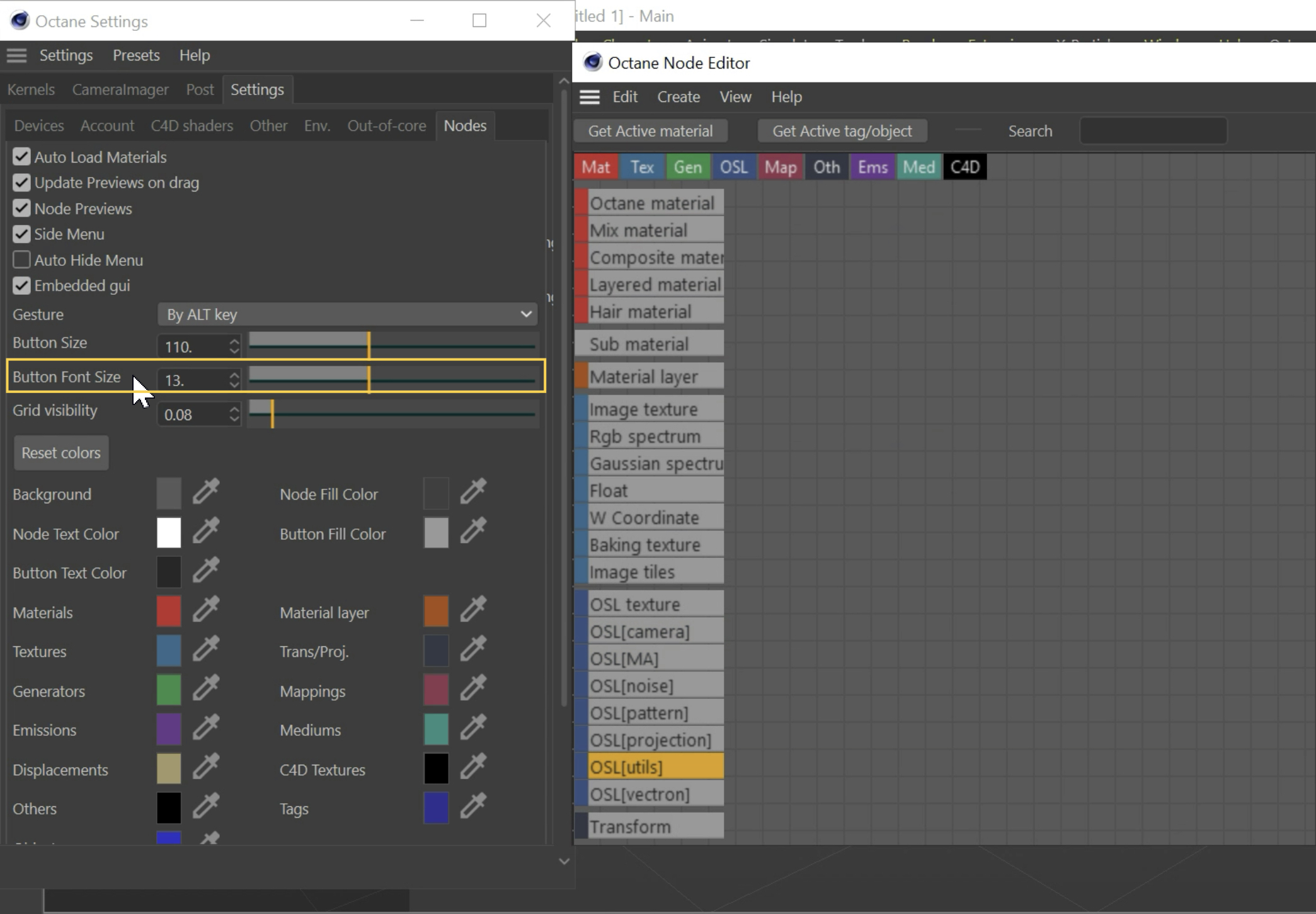

Why don't you increase font size rather than doing this? It's easier than I do whole drawing and input structures. I wrote all before R21 come out

Thanks beppe! But this won't help for all the other apps (Adobe, Music Production, Windows Task Bar and Explorer elements etc.) being way too small if Windows upscaling is disabled. Also the C4D layout itself looks very tiny even when using the biggest icons and bigger font size.

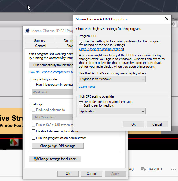

take a look
https://www.youtube.com/watch?v=pO4v_c6-hk0
OlyDarko
Posts: 18
Joined: Mon Jul 18, 2016 7:11 pm
aoktar wrote:
OlyDarko wrote:Thanks beppe! But this won't help for all the other apps (Adobe, Music Production, Windows Task Bar and Explorer elements etc.) being way too small if Windows upscaling is disabled. Also the C4D layout itself looks very tiny even when using the biggest icons and bigger font size.
take a look
Thank you, but this makes the whole C4D blurry..
