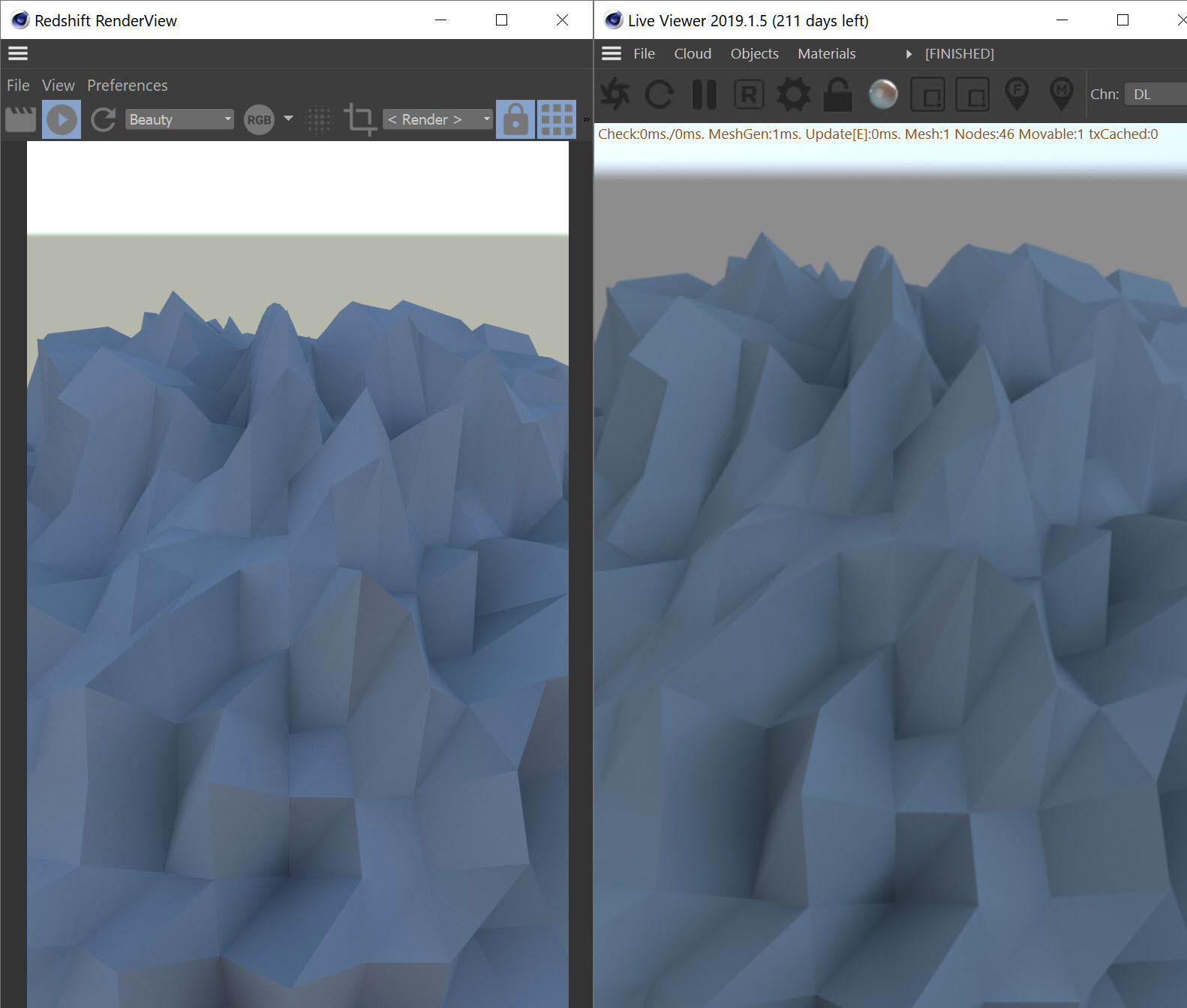

Postby OlyDarko » Sun Mar 15, 2020 2:44 pm
OlyDarko Sun Mar 15, 2020 2:44 pm
Hey guys, just wanted to ask if there is any update in sight on this?
Please also see attached screenshot (Octane and Redshift interactive render windows, Redshift is sharp. Corona window is sharp as well btw, Octane is the only renderer that is blurry..).
Cheers,
Oly
