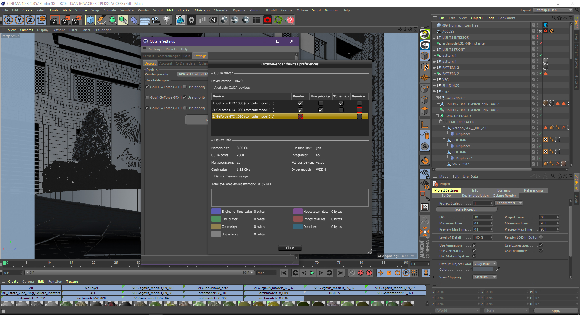

Thanks for all the hard work, Aoktar.
I can´t seem to realize when it began: Octane inside C4D is not using my 3 gpus...
Why is that? I have enterprise license...
When I check the same settings inside Stand alone version, it works as it should.
