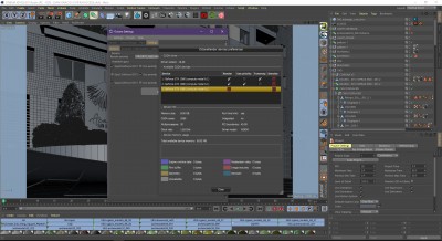

Yes! I have the same problem, I have observed also that Octane Texture Manager report is not correct for some files paths but It report it's OK with green check. I observed that the crashes may be due to materials for which Octane indicated the path, but in reality it did not load the textures in the previews even if the reload is done.
The path that causes the crash refers to texture in the "asset" folder which is located in the "tex" folder which is located in the folder where the C4d file is located.
I found that to cause the crash is a material that has 4 textures 7565x8500 pxls, of which three are about 15-18 MB each and one of 2.29 MB, but on Octane Texture Manager it arise to 245 MB each!
I have used this material several times in the past without problems now, however, with the 2019.1.5 version it crashes.
I have to delete it without starting the Octane plugin otherwise if I try to delete it the program crashes.
Please take note that I have opened some fliles that are 6 month older and now it crasches as I try to render, it crashes also as I try to select some material. I am sure the problem is texture. If I delete all texture and then render no crashes occur.

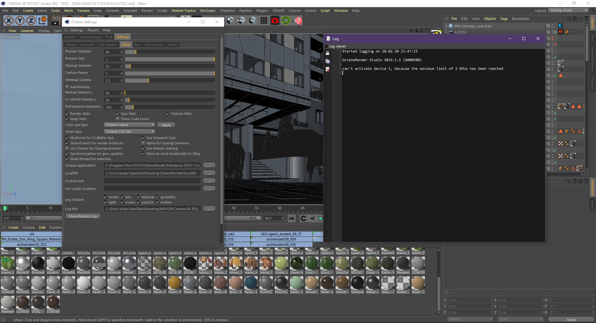

I can´t seem to realize when it began: Octane inside C4D is not using my 3 gpus...
Why is that? I have enterprise license...
When I check the same settings inside Stand alone version, it works as it should.
