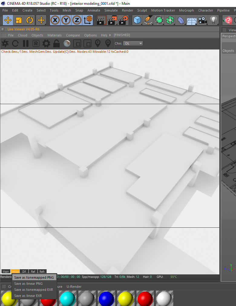

aoktar wrote:
thanulee wrote:Testing it atm. Small detail: when i save from LV the demain pass as "png tonemapped" the gamma is wrong.
Thanks!!
Maybe I'm blind, how do you get it? It seems fine to me
Here is an example: saving tonnemapped png from denoised pass.

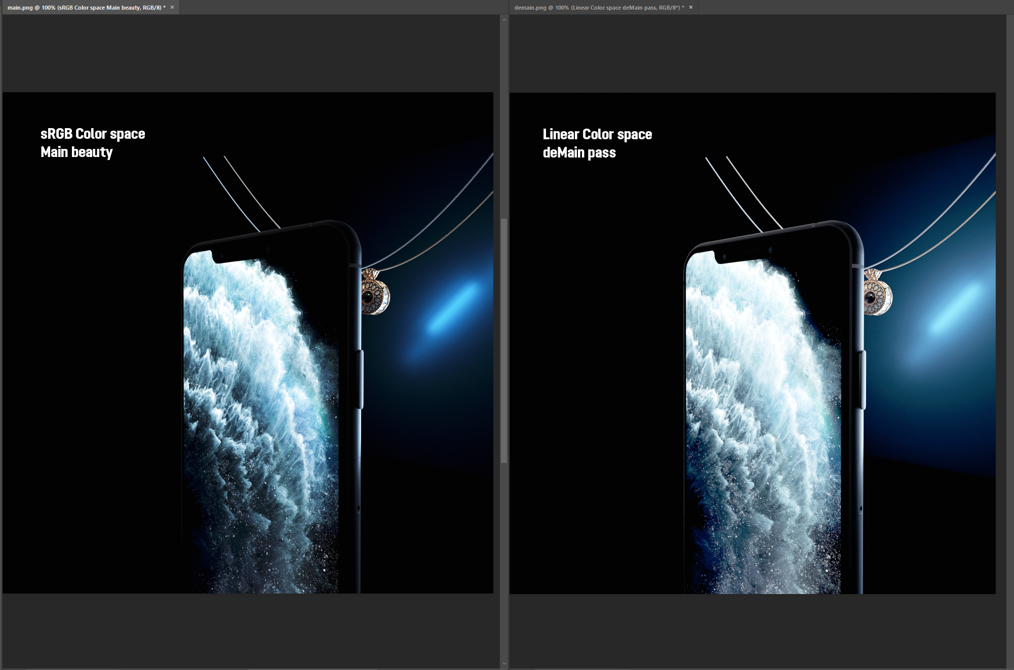

divasoft
Posts: 349
Joined: Thu Jul 01, 2010 3:59 am
Location: Russia
Thanks!!
if we save demain pass as "png tonemapped" we get image with linear color space instead sRGB.
In LV the pictures look the same, but if you open both in Photoshop, you will see that they look like different gamma. We need sRGB color space for all tonemapped passes.
