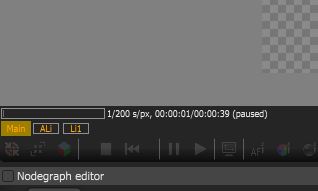

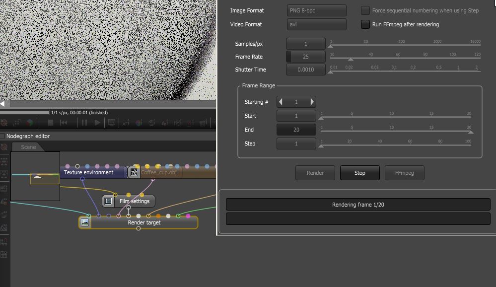

I still get the paused render bug where it only renders out 1 frame after increasing the s/px, is there a fix for this? I`m on 3.07 using the 1.21V
In the preview it renders out perfectly..

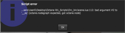

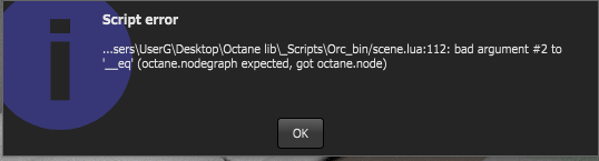

I'm having an error when pressing alt+a . Anyone had this problem ?

I updated the file render.lua, but it seems there is no change. It only renders and saves the first frame, and that`s it. No promts as well.
Also it outputs this log after updating the end of function Render.callback(rc) in the file render.lua .:
Code: Select all
Error raised in callback:
C:\Users\Desktop\MK\Orc_bin/render.lua:444: bad argument #7 to 'format' (number has no integer representation)
stack traceback:
	[C]: in function 'string.format'
	C:\Users\Desktop\MK\Orc_bin/render.lua:444: in method 'start'
	...ers\Desktop\MK\Orc_bin/Tab/animate.lua:438: in function <...ers\Desktop\MK\Orc_bin/Tab/animate.lua:412>
	[C]: in method 'showWindow'
	[string "Ol Ready Cam.lua"]:107: in main chunk
