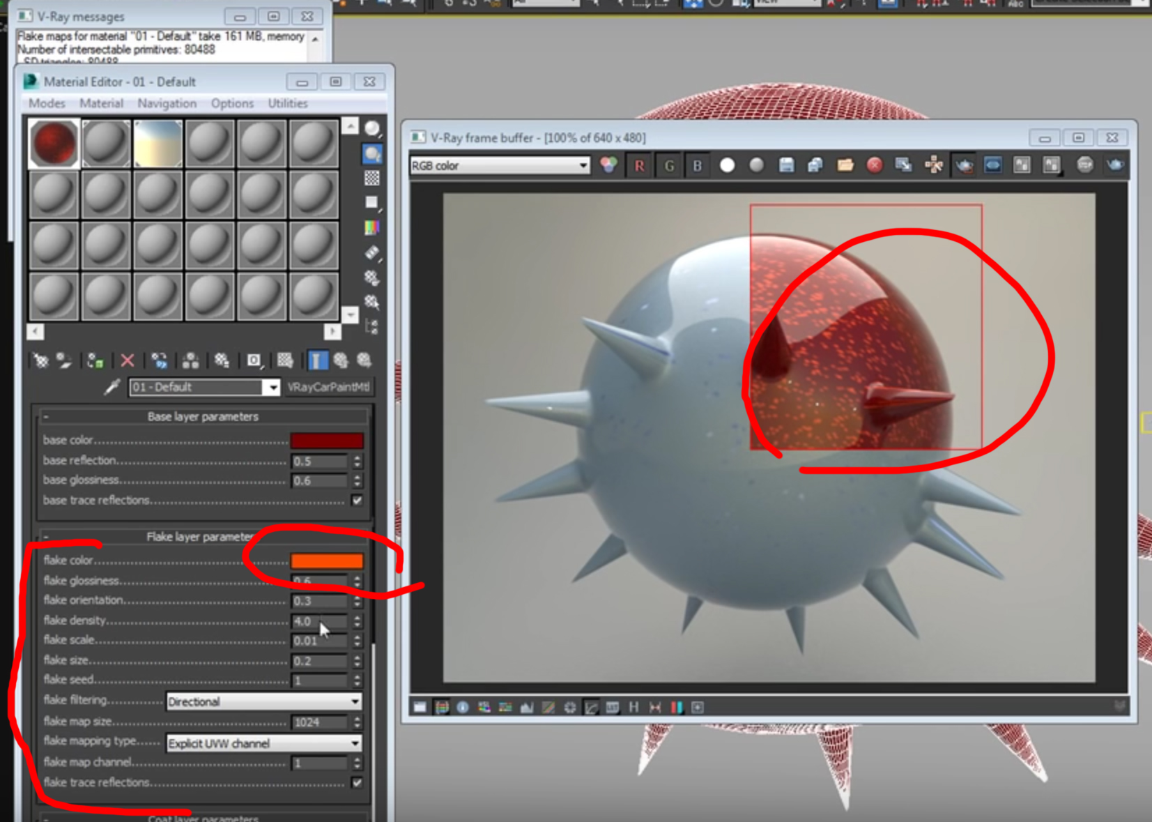

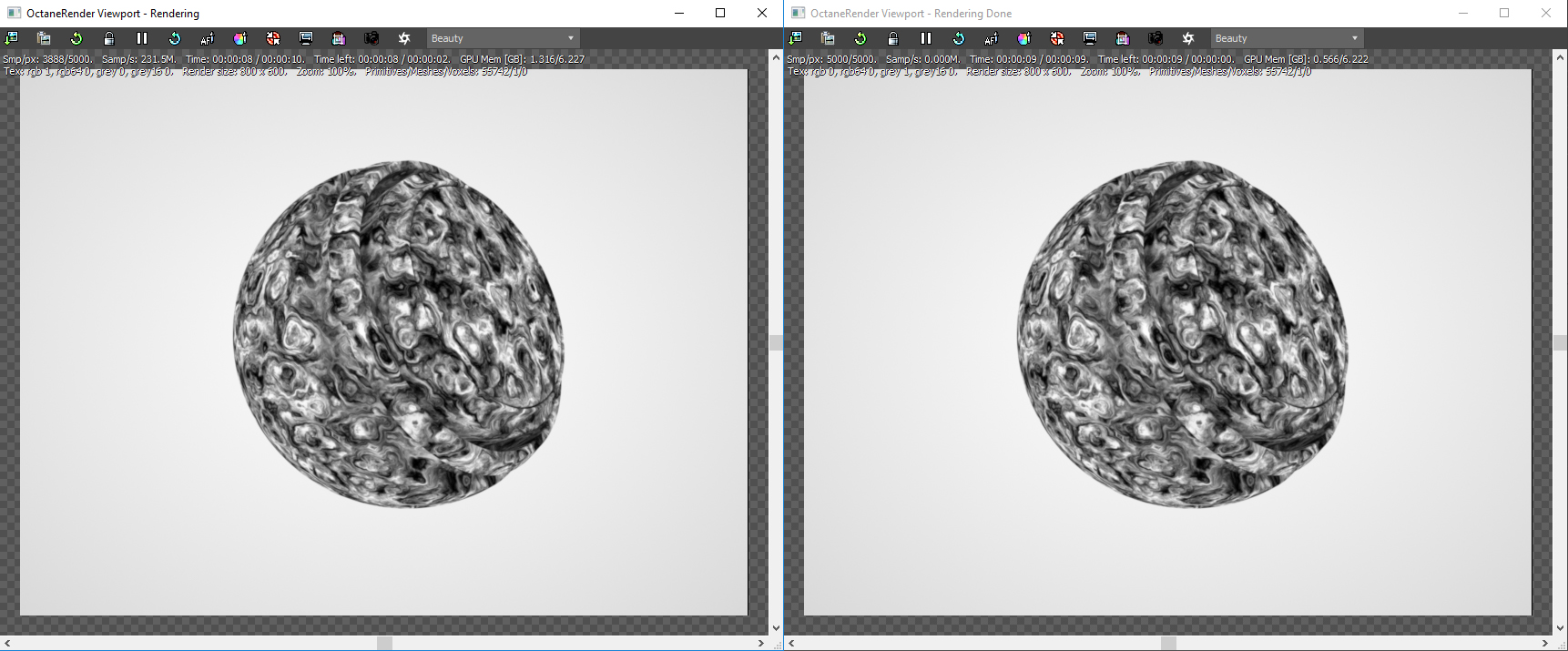

Thanks Paridie but how can you make those flakes sparkle. I tried mix texture with flake as a mix texture and they still dont sparkle at angles like in this video https://youtu.be/qpPQk5fNrho?t=1m10s
also I thought it is a procedural material why mapping looks off where circles are oval.
Thank you
