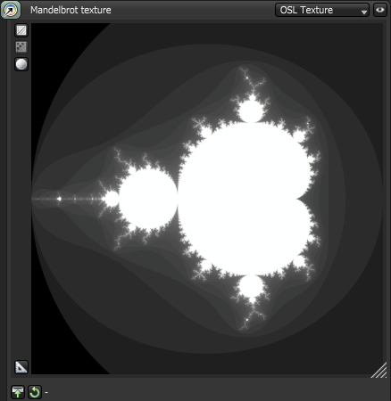

shader Mandelbrot(
    output color c = 0,
    int maxcount = 10
        [[int min=1, int max=20000, int sliderexponent=4,
          string label = "Max iterations",
          string description =
            "Maximal amount of iterations (z = z² + c)"]],
    int outputScale = 10000
          string label = "Iterations scale factor",
            "Scale factor, iteration count mapped to almost white"]],
    float gamma = 1.0
        [[string label = "Gamma", float min=0.1, float max=10]],
    point proj = point(u, v, 0)
        [[string label = "Projection"]],
    matrix xform = 1
        [[string label = "UV transform"]]
    // safety check: max count should not be arbitrarily high:
    int maxcount2 = min(maxcount, 20000);
    // get a point. This implements the usual UV transform + projection inputs
    // of Octane texture nodes
    point p = transform(1/xform, proj);
    float cx = p[0];
    float cy = p[1];
    // Iterations
    float x = cx;
    float y = cy;
    int count = 0;
    while (x*x + y*y < 4 && count < maxcount2)
        count += 1;
        // z = z² + c
        float x2 = x*x - y*y + cx;
        y = 2*x*y + cy;
        x = x2;
    // output value: 1.0 if the iteration doesn't diverge, < 1.0 otherwise
    if (count < maxcount)
        float h = (float)count;
        c = pow(h / outputScale, gamma);
        c = min(c, .99);
    else
        c = 1.0;
After compiling this texture can be rendered like any other Octane texture:

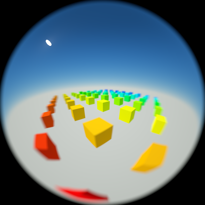

Camera
The following is a minimal implementation of a perspective camera. It takes into account the aspect ratio of the image
Code: Select all
shader OslCamera(
    output point  pos  = P,
    output vector dir  = 0,
    output float  tMax = 1.0/0.0)
    float pa;
    int res[2];
    getattribute("camera:pixelaspect", pa);
    getattribute("camera:resolution", res);
    float aspect = pa * res[1] / res[0];
    vector right = cross(I, N);
    dir = I + right * (u - .5) + N * (v - .5) * aspect;
Output variables
A camera shader has 3 outputs representing a ray (note that the names are arbitrary):
point pos = Ray position:
This is often set to P, but it may be set to other points to implement depth of field, or a near clipping plane
vector dir = Ray direction:
The render engine will take care of normalizing this vector if needed.
float tMax = Maximum ray tracing depth:
Measured along the direction of dir. May be used to implement a far clipping plane.
Set to 1.0/0.0 (infinity) to disable far clipping.
If tMax is 0, or if dir has 0 length, the returned ray is considered invalid, and the renderer will not perform any path tracing for this sample.
Accessing the camera position
Like other camera types, OSL camera nodes have static input pins which define the position and orientation of the camera. It is not mandatory for your camera shader to use this position, but if it does your camera automatically supports motion blur and stereo rendering.
Within camera shaders, the position and orientation of the camera is available via the standard global variables defined by OSL:
point P: Camera position
vector I: Camera direction (sometimes called *forward*)
normal N: vector, perpendicular to I
float u, float v: Coordinates on the film plane, mapped to the unit square. (0, 0) is at the bottom-left corner. These coordinates can be fetched via getattribute("hit:uv", uv) and via the UV projection node.
Alternatively, the camera position is also available via the "camera" coordinate space. This is usually an orthonormal coordinate space. Without transform the camera is looking along the -Z axis with the +Y axis as up-vector, i.e. the axes are defined as:
+X: Right vector
+Y: Up vector
–Z: Camera direction
Using this the last line of the example above may be written as:
Code: Select all
dir = vector("camera", 1.0, (v - .5) * aspect, (u - .5));

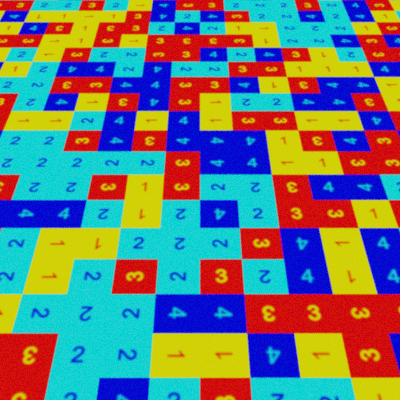

#include <octane-oslintrin.h>
shader Texture(
    color col1 = color(1, 0, 0),
    color col2 = color(0, 1, 0),
    color col3 = color(0, 0, 1),
    color col4 = color(1, 1, 1),
    output color c = 0)
    int rnd = (int) floor(16 * noise("cell", u, v));
    // random rotation
    float u2 = (rnd & 1) ? u : v;
    float v2 = (rnd & 1) ? v : -u;
    u2 = (rnd & 2) ? -u2 : u2;
    v2 = (rnd & 2) ? -v2 : v2;
    // random index
    int index = rnd >> 2;
    if (index == 0) { c = _evaluateDelayed(col1, u2, v2); }
    if (index == 1) { c = _evaluateDelayed(col2, u2, v2); }
    if (index == 2) { c = _evaluateDelayed(col3, u2, v2); }
    if (index == 3) { c = _evaluateDelayed(col4, u2, v2); }
