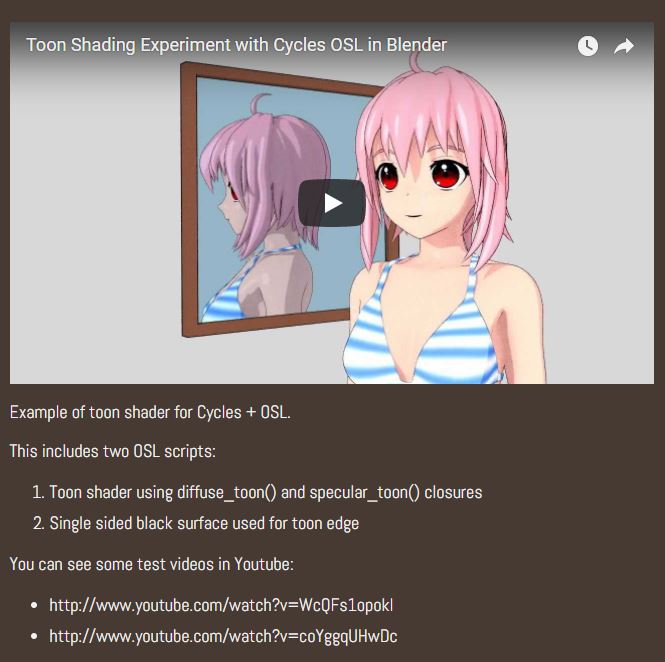

Has anyone used osl/toon stuff to do any technical drawing type renders by any chance?.. I have to bang out a couple in the next couple weeks, and ordinarily I would render something and trace it in AI, which is rather time-consuming...

Outlines via OSL might be a good companion for the new toon shader. I've not seen any OSL shaders for this type of thing yet.

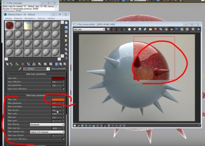

Hi coilbook,coilbook wrote:can anyone make a sparkle shader like for snow? Or can otoy do it? I think it is a very necessary shader Thank you
could flake osl to help?
viewtopic.php?f=27&t=66015
Regards
Paride

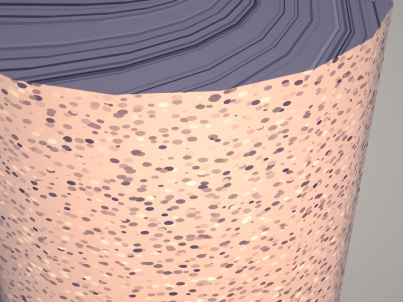

Thanks Paridie but how can you make those flakes sparkle. I tried mix texture with flake as a mix texture and they still dont sparkle at angles like in this video https://youtu.be/qpPQk5fNrho?t=1m10sparide4331 wrote:Hi coilbook,coilbook wrote:can anyone make a sparkle shader like for snow? Or can otoy do it? I think it is a very necessary shader Thank you
Regards
Paride
also I thought it is a procedural material why mapping looks off where circles are oval.
