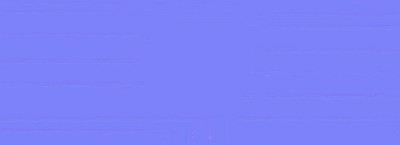

Hehe, they are notface_off wrote:The normal maps look blank to me.

Right, I think that's the reason why it's not possible to mix several normal map together with Octane,face_off wrote:Are you sure that not because the normal map has RGB channels mapping to an XYZ vector?
Paul
But my point is: as the Modo octane.createUdim command mix the Udim tiles together using multiply nodes, that's why it doesn't works also in Modo,
the normal map input of octane material doesn't support multiply node as input: the result is the same as if nothing was connected...
Here is a Modo scene to demonstrate that,
the Udim nodegraph as been created with the octane.createUdim command,
and as you can see it doesn't work at all for normal map,
but works if the node is used for diffuse for example.
