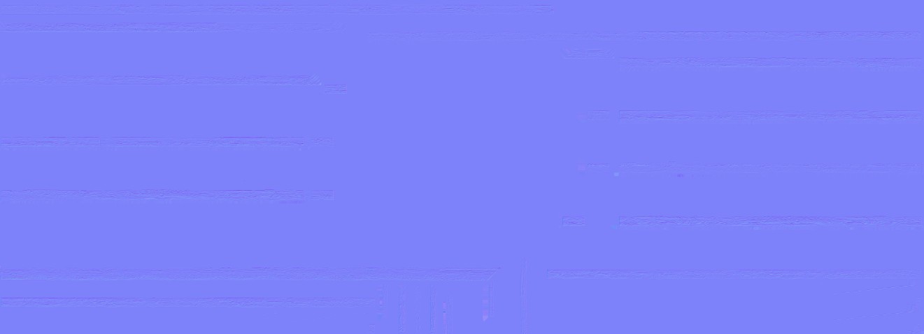

face_off wrote:The normal maps look blank to me.
Hehe, they are not :)

Can you send me the scene and UDIM files so I can take a closer look pls?

face_off wrote:Are you sure that not because the normal map has RGB channels mapping to an XYZ vector?
Paul
Right, I think that's the reason why it's not possible to mix several normal map together with Octane,
But my point is: as the Modo octane.createUdim command mix the Udim tiles together using multiply nodes, that's why it doesn't works also in Modo,
the normal map input of octane material doesn't support multiply node as input: the result is the same as if nothing was connected...
Here is a Modo scene to demonstrate that,
the Udim nodegraph as been created with the octane.createUdim command,
and as you can see it doesn't work at all for normal map,
but works if the node is used for diffuse for example.

Calus - you are right. I was unaware of that limitation with Normal Maps. Unfortunately it break the entire UDIM process. May I suggest requesting OTOY to fix this, as it's a pretty major issue.

face_off wrote:Calus - you are right. I was unaware of that limitation with Normal Maps. Unfortunately it break the entire UDIM process. May I suggest requesting OTOY to fix this, as it's a pretty major issue.
Well OctaneRender team is already aware of the issue (at least Roeland).
In 3.0.4, normal map has been revisited to work with bump but the normal map limitation has not not been removed.
So I fear we'll have to wait for the new texture sytem wtih OSL in later 3.1 *,
UDIM (and other mutli-tile convention) may be supported natively in Octane core at some point.

face_off wrote:May I suggest requesting OTOY to fix this, as it's a pretty major issue.
Octane Normal Map have been improved in Octane core and don't have anymore the previous limitation since Octane3.06Test4 :)
So UDIM Normal map should be supported now in Modo since this version:
viewtopic.php?f=34&t=55078&start=340#p308769
(UDIM displacement is still not supported)

Yes - thanks. Normal maps setup as UDIM's should now work in the Modo plugin (when using the octane.createUdim command).
