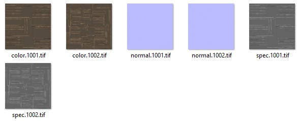

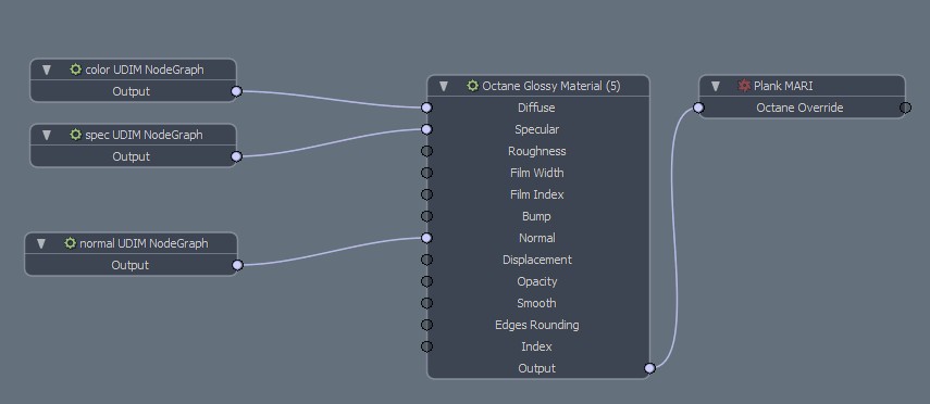

I can not get it to show anything, that's my problem. And I am unsure if I have done it correctly (the maps are made in MARI).
3D Generalist.

The normal maps look blank to me.
