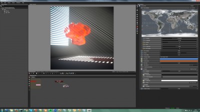

here's my environment settings...

Paolo Giandoso wrote:Umh, it is weird, I switched to PMC, parallelel samples like usual, caustic blur to 0, and while it does goes nice for volumetric in general (15 mins), the volume caustics are now gone :(
Is it possible that they only work in PT?
I'm very sorry and you should keep PMC kernel. ;)
If you can have long time then you should increase minimum ~120,000 samples per pixel for very good accuracy of caustics.
If you can't have long time then:
- you increase the scale of light área to blurrier caustics and to less samples per pixel.
or
- you may upgrade from your 1x GTX 970 to 4x GTX 980 Ti, sorry. NOTE: Currently, GTX 1080 isn't supported yet...
If you want animation then you may increase caustic blur to 0.01 or to 0.05 at PMC. ;)
