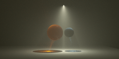

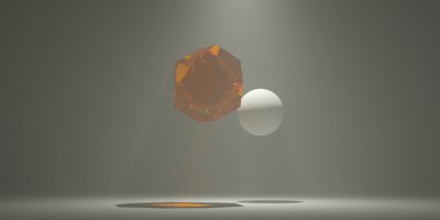

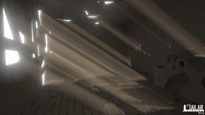

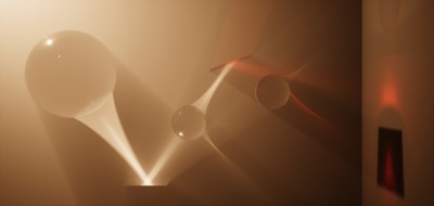

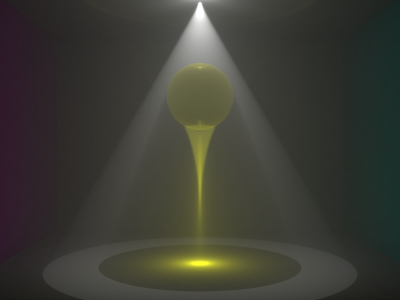

I am kinda banging my head on the wall here into trying to reach a result like the attached pictures (clear volumetric shadows, and a caustic shadow too if it is even possible)
I have a GTX 970. I tried connecting a volume medium to an environment pass (I tried both HDRI and Daylight) I played with Density and Absorption and Scattering, and I put the Phase to forward scattering. No matter what options I put i I only get a foggy atmosphere, it render super slow and there is not the slightest hint of the neat shadow casting I would love to obtain.

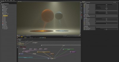

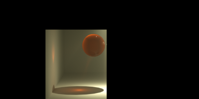

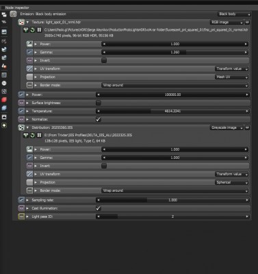

No, I guess the radius is sufficient, I made sure. I made several test, and it seems to also depend a lot from the size of the light. I used a small plane as light sourse with a realistic texture and a IES profile, and now light rays do appear, but they are so incredibly faint, no hint of the sharp caustic effect I am looking for :\

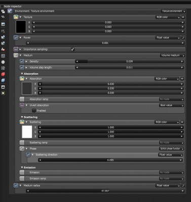

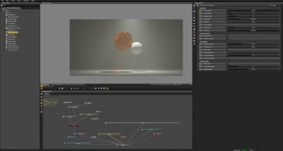

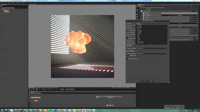

Here is my shot, after 12 hours it is still super grainy at low res. Is there any setting I am missing? I am using PT because I am interested in Deep rendering, Caustic Blur to 0.01 and Parallelism 01 (no Idea of what it actually does, but I read it helps), Also I kept Absorption to 0.
My Kernel Settings
My Kernel Settings
My Environment node
My Environment node
My Light Plane Emission Material

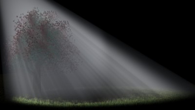

try experimenting with the "Length unit" on the import settings...

These are tests I made using the scattering medium in place of the volume medium. Seems really more effective, the volume caustics do appear, still very faint though. I wonder if there is a way to push them further.
womble wrote:try experimenting with the "Length unit" on the import settings...
The attachment blob2.jpg is no longer available
Good point Womble! (and beautiful render, Those are really cool light rays!)
My scene was 3or 4 meters big I´ll try now a tests with a smaller scale!

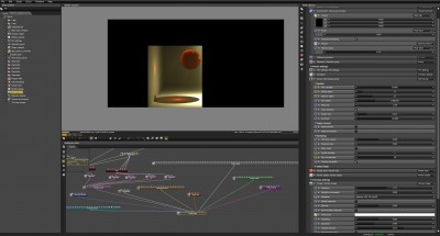

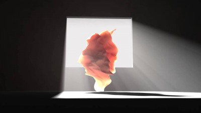

Here is a test with scale set to cm
2h rendering parallelism 1, PT
Much more visible these time :). But it does take incredibely long for a single frame, and it is not even close to being finished. :/
