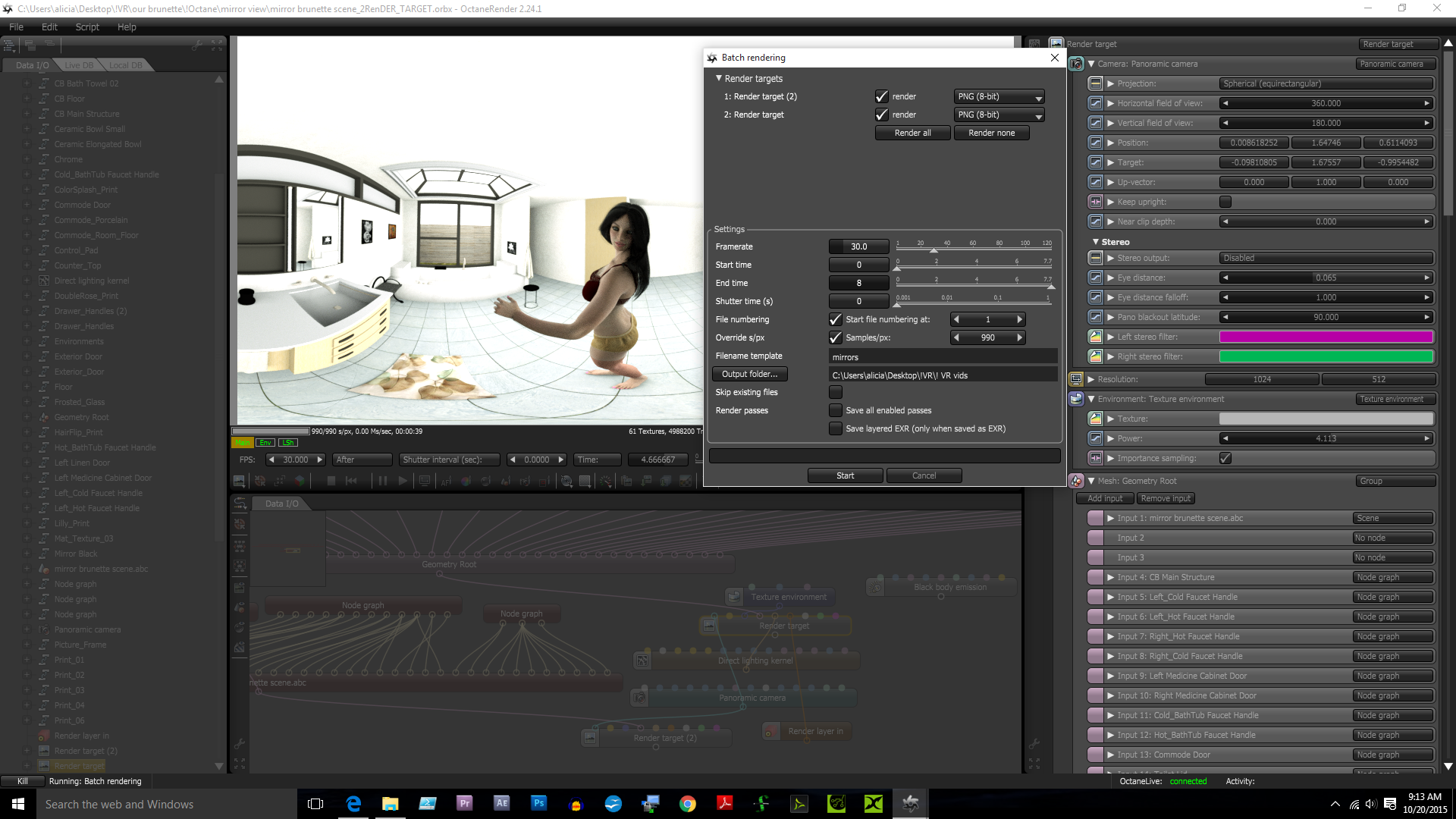

stratified wrote:Hi all,
I've spent some time combining the batch render script with the render animation script. This script will ship with the next release of the standalone. We already want to put it out here so you can already use it and help us find some bugs
thanks,
Thomas
Hi, I am having an issue with the script. For some reason it won't number the frames -- instead it keeps writing the frames over and over again , example, instead of going mirrors 1, mirrors 2, mirrors 3 --it just writes mirrors. I am sure I set everything up right --here's a screenshot of the work...
WIN 10 64 | Geforce 970| 16 GB

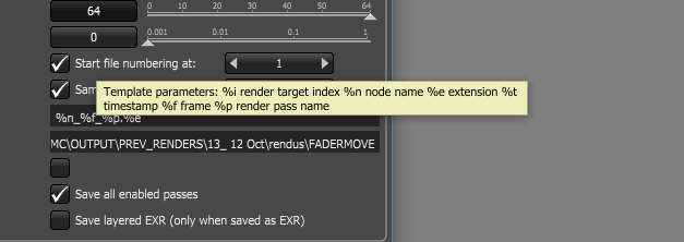

Hi Luv, to add frame number you need to add the "%f" switch after your filename in the templateLuvMultimedia wrote: Hi, I am having an issue with the script. For some reason it won't number the frames -- instead it keeps writing the frames over and over again , example, instead of going mirrors 1, mirrors 2, mirrors 3 --it just writes mirrors. I am sure I set everything up right --here's a screenshot of the work...
in your exemple this should be : mirrors%f%e
etc... the switches are listed in the popup.
Vincent.
