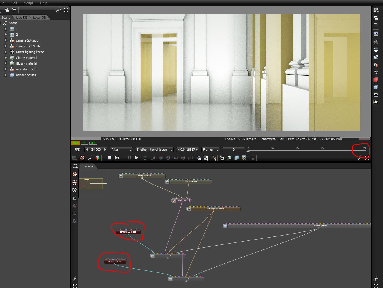

i'm doing a pretty long video next week and i'm testing workflows right now. This script will help a lot!
But there's one thing, maybe you can help me. In my workflow i use animated cameras exported from Max. My problem is that if i export cameras with different frame count the animation slider shows only the longest one even if i select the render target with the shorter frame count pinned into.
That's an example test. I have 2 cameras, one with a 237 frames animation and one with a 50 frames animation. The number that i see on the frame slider it's 237 with both render target. If i render this setup with the script in this post i get 237 frames for each animation.
if i delete the 237 frames camera the animation slider goes back to 50 frames.
