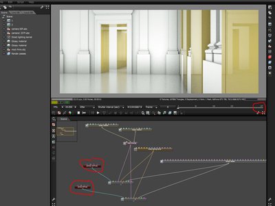

But there's one thing, maybe you can help me. In my workflow i use animated cameras exported from Max. My problem is that if i export cameras with different frame count the animation slider shows only the longest one even if i select the render target with the shorter frame count pinned into.
That's an example test. I have 2 cameras, one with a 237 frames animation and one with a 50 frames animation. The number that i see on the frame slider it's 237 with both render target. If i render this setup with the script in this post i get 237 frames for each animation.
if i delete the 237 frames camera the animation slider goes back to 50 frames.

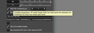

Hi, I am having an issue with the script. For some reason it won't number the frames -- instead it keeps writing the frames over and over again , example, instead of going mirrors 1, mirrors 2, mirrors 3 --it just writes mirrors. I am sure I set everything up right --here's a screenshot of the work...
WIN 10 64 | Geforce 970| 16 GB
vinz
Posts: 230
Joined: Fri Apr 09, 2010 5:00 pm
Location: France
LuvMultimedia wrote: Hi, I am having an issue with the script. For some reason it won't number the frames -- instead it keeps writing the frames over and over again , example, instead of going mirrors 1, mirrors 2, mirrors 3 --it just writes mirrors. I am sure I set everything up right --here's a screenshot of the work...
Hi Luv, to add frame number you need to add the "%f" switch after your filename in the template
in your exemple this should be : mirrors%f%e
etc... the switches are listed in the popup.
Vincent.
