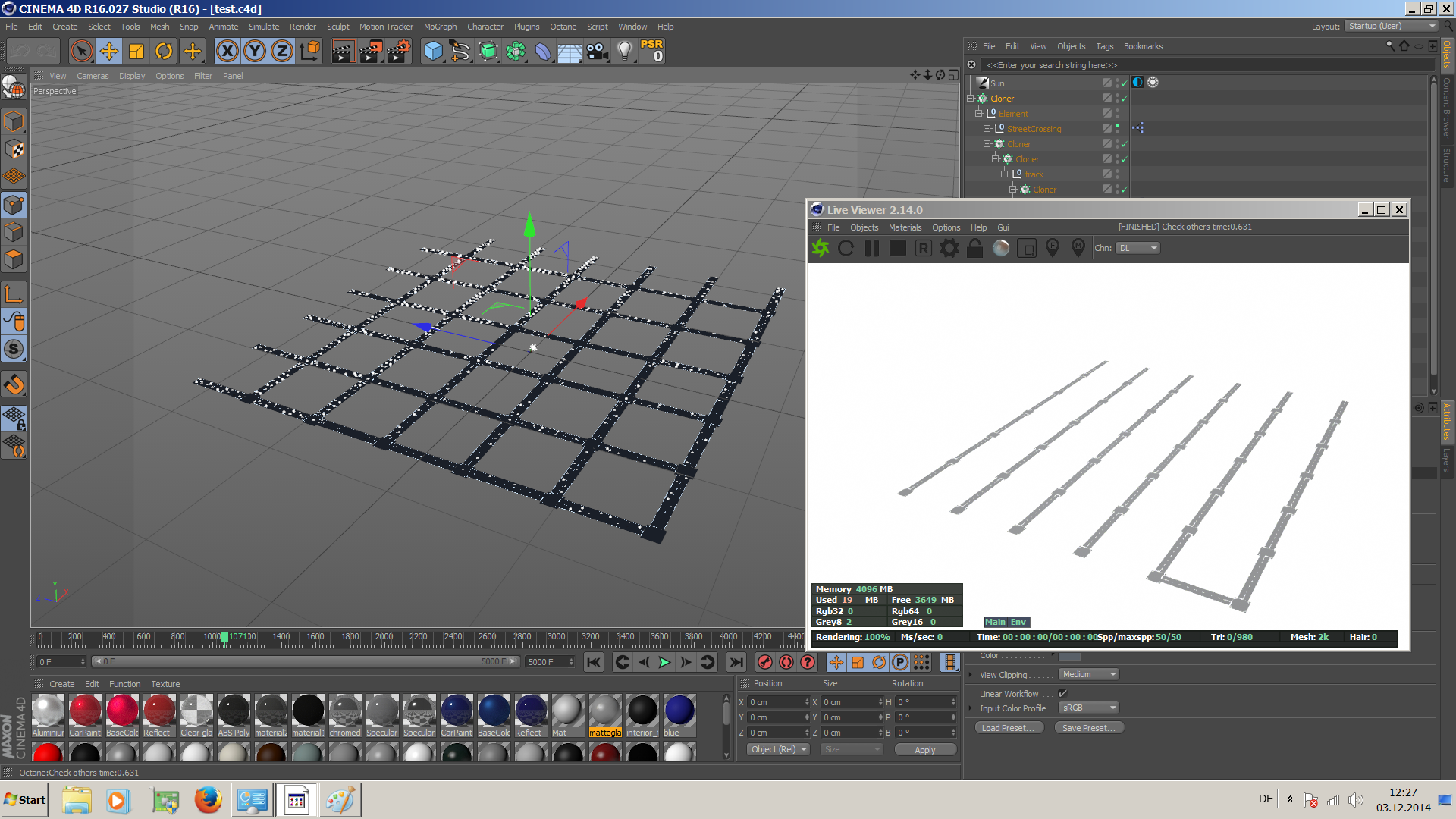

There seems to be a bug with the Cloner:
When "Render instances" is checked within the top most Cloner object I get missing geometry in the Octane Live View window after syncing (pressing the free button).
See attached example.
Is this just me or a bug? :)

rschrem wrote:There seems to be a bug with the Cloner:
I've tested this and everything is working fine!

I've tested this and everything is working fine![/quote]
Hm, I added a screenshot. Did you also use Cinema R16 and the latest version of octane plugin?

OK with further testing after looking at you OM, Octane can't render render instances of render instances. This happens every time you try to nest render instances inside other render instances.
Ahmed, is this a limitation or a bug?

pBarrelas wrote:OK with further testing after looking at you OM, Octane can't render render instances of render instances. This happens every time you try to nest render instances inside other render instances.
yes, it's a limit. Not easy to handle it for realtime structures. I'll look for improvements on the future. But currently we have to work like that.
