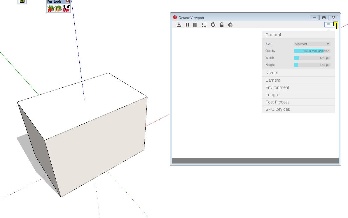

Hi
I've just got this problem today.
When I open the Octane window, nothing happens :-/
I have tried both repair and reinstall the octane plugin, and removed all other plugins from
C:\Users\bre\AppData\Roaming\SketchUp\SketchUp 2014\SketchUp\Plugins
The standalone version and 3ds max plugin runs fine.
Does anyone know what might be the problem?
Sketchup pro 2014 v14.1.1282
Octane standalone 2.06
Octane plugin 0.11.53
Octane won't render

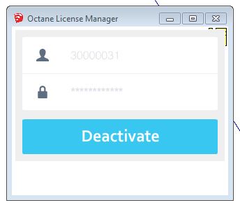

Hi fuzzybro
I have been able to run the same octane for sketchup fine before . I have to tried to deactivate via octane menu, but the deactivate but the button is somehow grayed out.

What was the change that made it stop working? Updated to a new version?
When you press "Deactivate" it takes some time to actually do the deactivation.
Also, could you please open octane materials window? Is it working?
Hi Fuzzybro
I can open materials window, and it works just fine.
I've got a new router, that might be the problem?
Can't deactive even if I wait very long.
I can add that both the standalone and the 3ds max plugin works fine.

Hi Fuzzibro
I forgot to mention that I installed Sketcup 2014, while still having Sketchup pro 8 installed.
I just opened Sketchup pro 8, and the Octane plugin works just fine in here, but again I can't select deactivate :-/

Wow, that's super weird.
Ok, try deleting license.cfg file located in C:\Users\%USERNAME%\Documents\Octane\SketchUp
and then deactivating SU license in your Customer Area page http://render.otoy.com/account/octanelive.php
This will help you to deactivate.
As for rendering issue, wait for new build, I'll prepare it this week, it might solve some problems.
