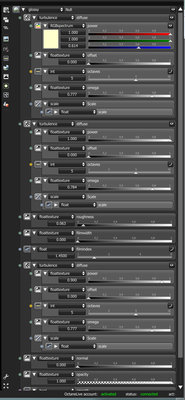

How did you made the sand? I need to create a similar effect, so can you share the process?

The sand is very simple : purely procedural : a simple glossy material with turbulence texture.
I copied also the turbulence texture in the bump slot and specularity slot. Not more !

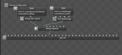

I can't connect nodes - How??
see:
But please should capture images or record video-youtube (video is recommended) for my easy/better understand because sorry, I can't understand your phrases. ;)

You need to use texture nodes-> connect in a material node -> then connect in the material inside your obj, your texture must be a floatimage (gray gradients are less memory consuming)
See the screen capture
