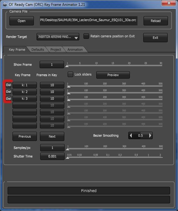

Postby Refracty » Tue Feb 17, 2015 2:08 pm
Refracty Tue Feb 17, 2015 2:08 pm
How can I delete keyframes?

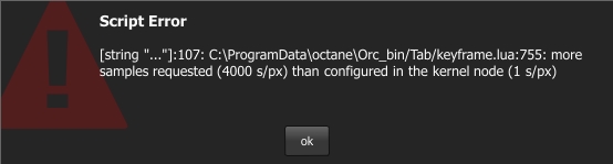

Postby ssouth » Wed Mar 04, 2015 4:41 am
ssouth Wed Mar 04, 2015 4:41 am
Hi all, I'm trying to use Octane 1.50 with ORC 1.21
getting this error:
The script crashes when I press [Alt] + [R] to run ORC
Any thoughts?
Thanks,
Steve
ssouth
Posts: 37
Joined: Fri Oct 05, 2012 1:23 pm
Re: Smooth & Easy Camera Animation for OR Standalone, ORC v1.21
Postby ssouth » Thu Mar 26, 2015 10:22 pm
ssouth Thu Mar 26, 2015 10:22 pm
Ok, was able to finally sit down and look at the code... and fixed (at least to my satisfaction) the issue I was having. Seems the render call was defaulting to 4000 samples/pixel but was being told to do just one/pixel...
so I added a couple lines to the code to set the sample/pixel variable.
Here render.lua:
Code: Select all
 373       octane.render.start
 374       {
 375           renderTargetNode = self.targetNode,
 376           maxSamples       = samples,            -- added this line
 377           callback         = self.callback,
 378       }
and here keyframe.lua:
Code: Select all
754    octane.render.start
755    {
756        renderTargetNode = Render.targetNode,
757        maxSamples       = keyframe.samples.slider.value,  -- added this line
758        callback         = Render.callback
759    }
ssouth
