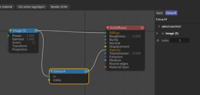

eyeonestudio wrote: Mon Jul 20, 2026 5:01 pm Thank you for the update.
Added output type to Image Texture and OSL Texture nodes
Could you please explain what this update actually means and how it should be applied?
Without any additional explanation, it is difficult to understand how to use this new feature.

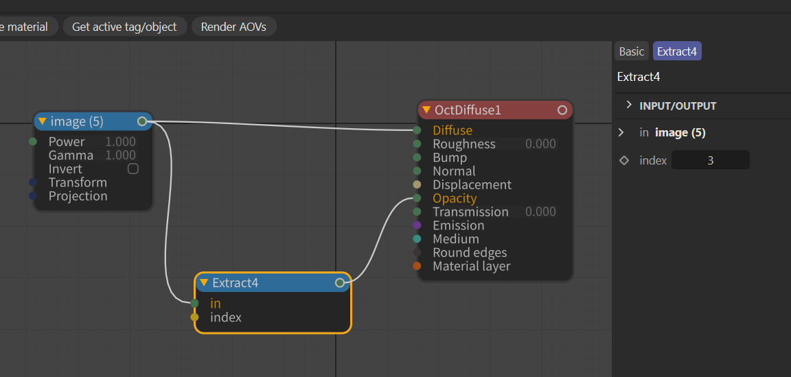

Very easy, if you for example want to use an imagetexture which has Alpha for color but also utilize its alpha channel at the same time, do this:
Just use an Extract4 (MX) node and set it to ID = 3 (0 = R, 1 = G, 2 = B, 3 = A)

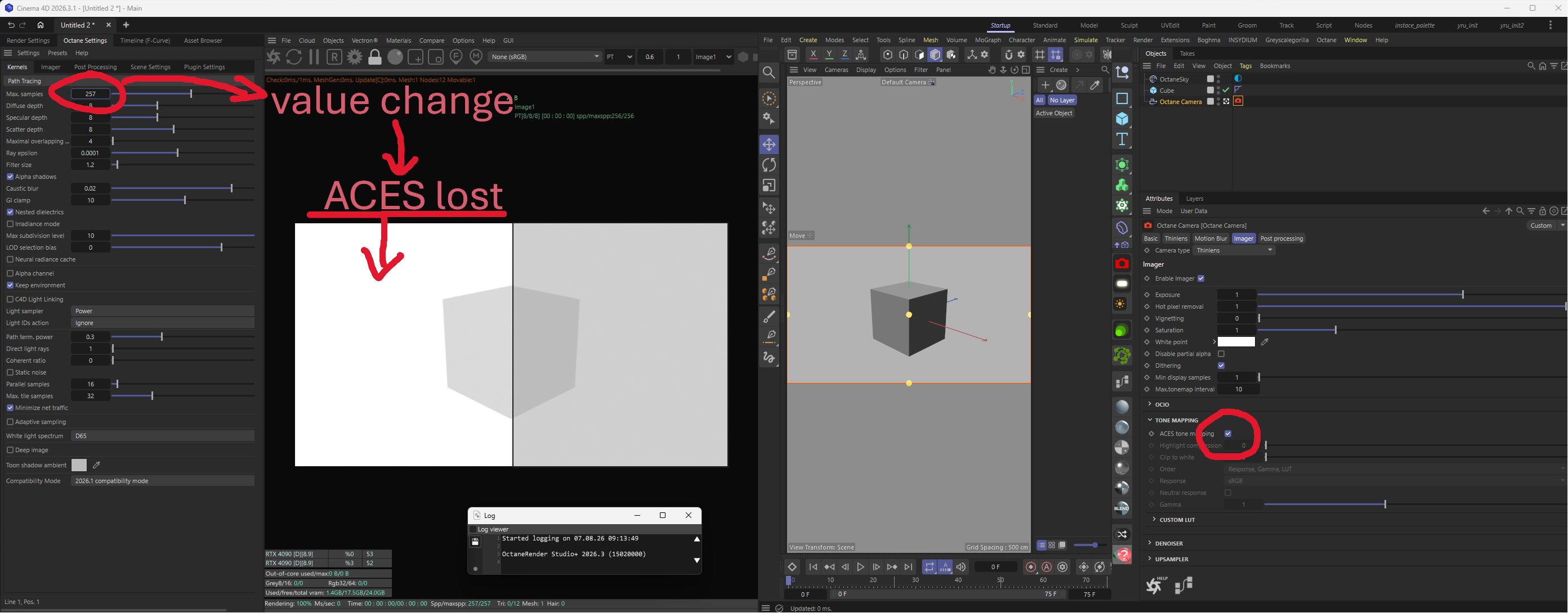

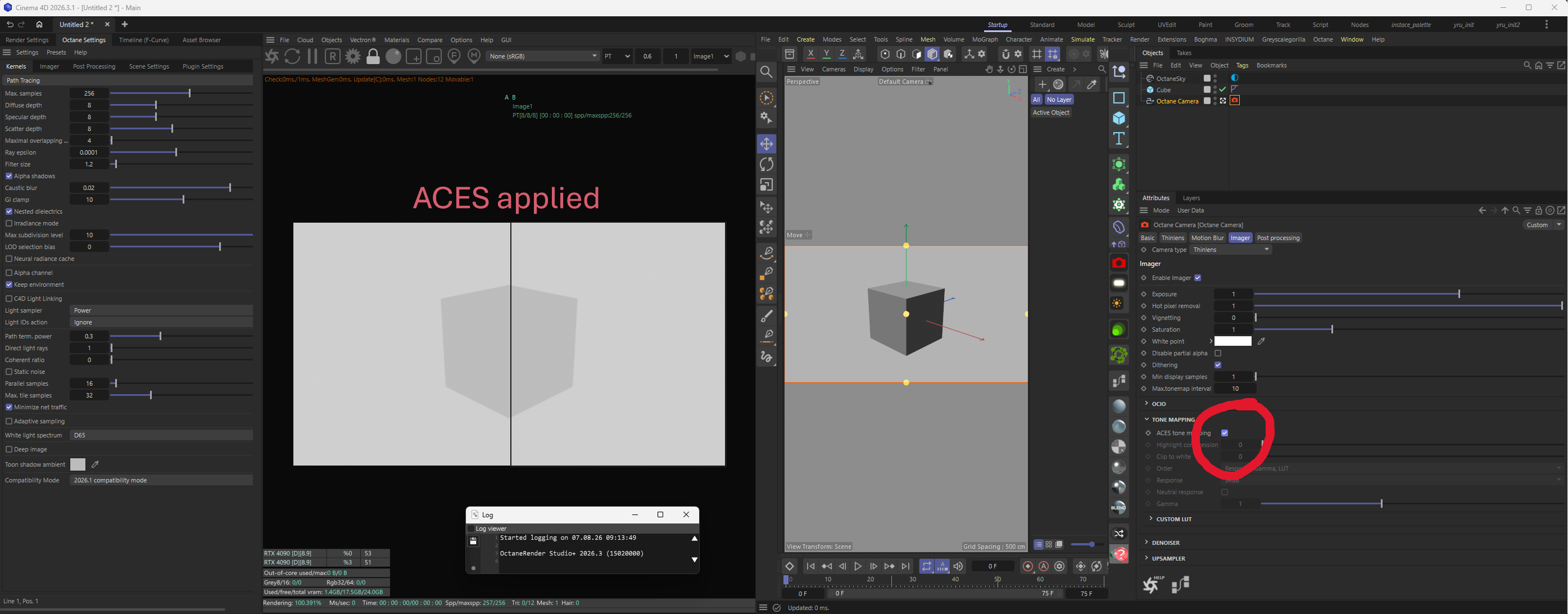

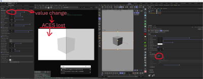

Hi, for the past few versions, whenever changing settings like "Max Samples" or enable "Adaptive Sampling" in the Octane Settings,
the ACES tone mapping setting in the camera tag is reset, and the image is displayed in the Picture Viewer without ACES.
I prefer to work with settings per camera rather than global camera settings. It would be great if you could fix this. Or is this just on my end?
I also noticed that the Transform and Projection nodes are no longer in the node menu on the left side of the Node Editor, or i´m blinde.
I know I can find them using the Tap key, but out of muscle memory for years, I'm sometimes faster using the menu on the left side of the Node Editor than using the Tap function.
Thank you.

y81r wrote: Fri Aug 07, 2026 8:55 am Hi, for the past few versions, whenever changing settings like "Max Samples" or enable "Adaptive Sampling" in the Octane Settings,
Thank you.
Live viewer does behave oddly at times when I touch kernel settings.
Tone mapping loses its original configuration or something.
Reloading the scene in Live viewer window fixes it.
So no, you are not the only one facing this issue AFAIK.
