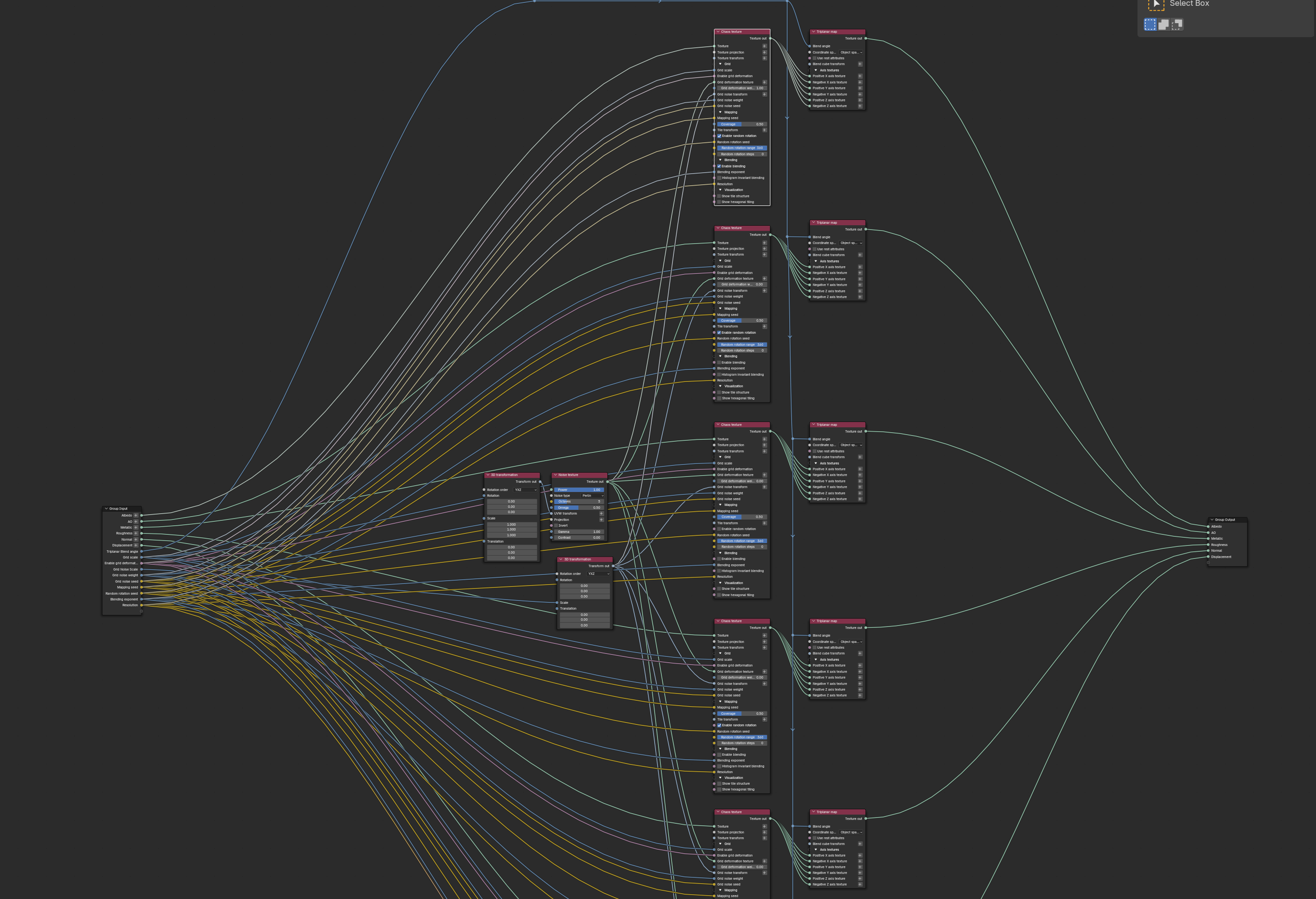

I’ve been experimenting with the Chaos Texture node and ran into a problem. I’m using several Chaos Texture nodes with identical settings to drive multiple bitmap maps for a material (around 6 maps per material). However, when I add multiple such materials into a scene, the render slows down dramatically or the Octane Server even crashes.
Did I understand correctly that the Chaos Texture can only be used this way — directly connected to each map — and that there’s no option to generate a reusable projection once and then apply it across different maps?
Thanks in advance for any clarification or best practices

I can share a material setup that is causing problems (I cannot share the full scene because of NDA). In that scene, I’m using this exact setup for three or four different materials with different textures, and whenever I switch to Chaos textures, the issues start to appear

dopelessdesign wrote: Tue Nov 25, 2025 11:52 am
Yes that is correct, at the moment it cannot be used as you would use a projection, you have to repeat the configuration for each texture. The reason is that the algorithm doesn't produce a single location to sample the input texture from but multiple locations with associated blending weights, and that doesn't fit with how projections work (This is a core limitations, not Blender specific). It might be possible to improve this in the future we'll keep looking into it.

Thanks for the responses. Sure, it’s not a top‑priority issue, but it would be nice to have it "fixed" — the Chaos Texture is a really cool node, and it would be great to be able to use its full potential. 8-)
