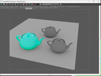

Hi coilbook,
I gave it a try, it looks like it works by leveraging AOV groups. Take a look and see if what you need is feasible along these lines.
Regards
Paride
Regards
Paride

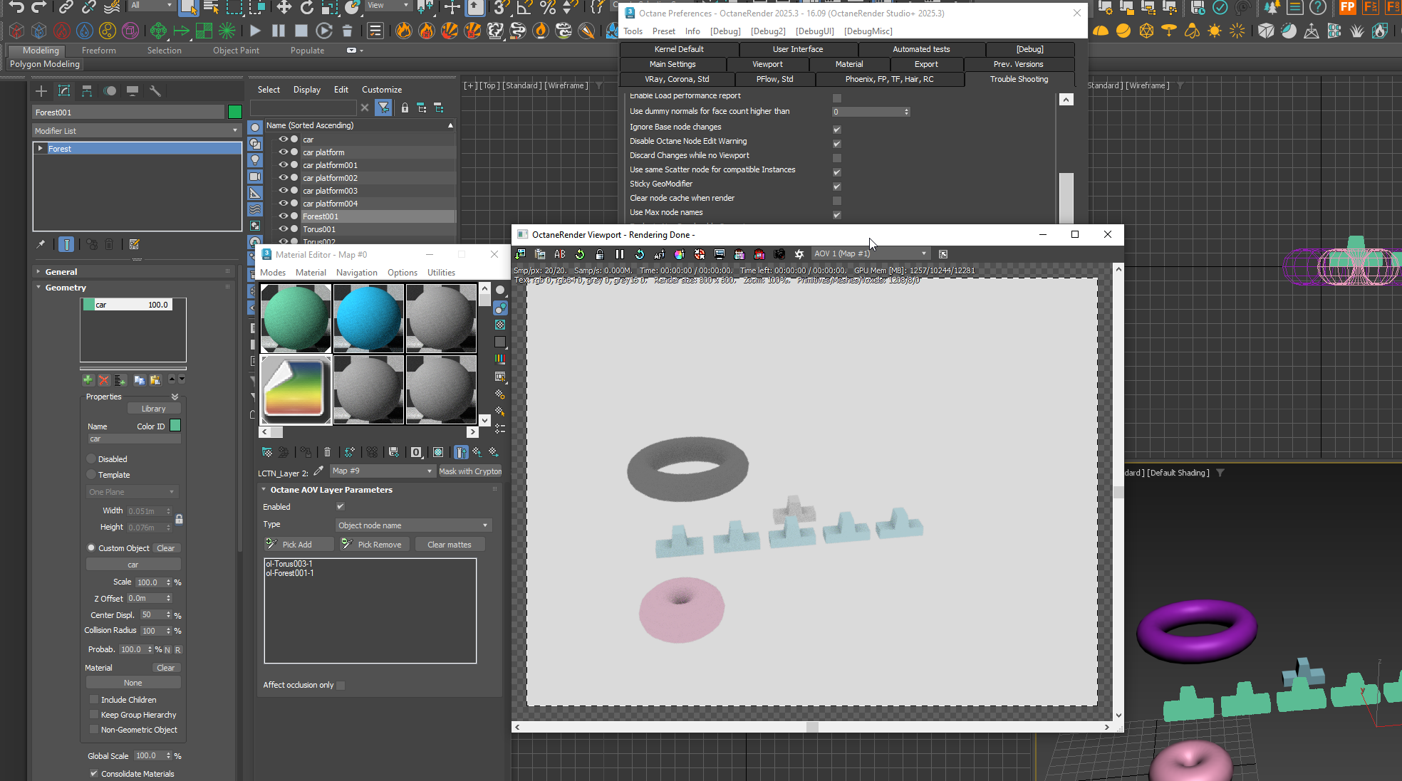

- neonZorglub
- Posts: 1103
- Joined: Sun Jul 31, 2016 10:08 pm
Hi coilbook,paride4331 wrote: Wed Sep 17, 2025 12:44 pm Hi coilbook,
It may seem that way, but I think it makes more sense to split between the objects that should be desaturated and those that shouldn’t.
Regards
Paride
Using the same AOV idea as Paride, you can also select the objects using cryptomatte mask.
There should be a crypromatte 'type' that fits your needs.
Here is a sample using 'Object node name' : (make sure Preferences/Troubleshooting/Use max node names is enabled)
