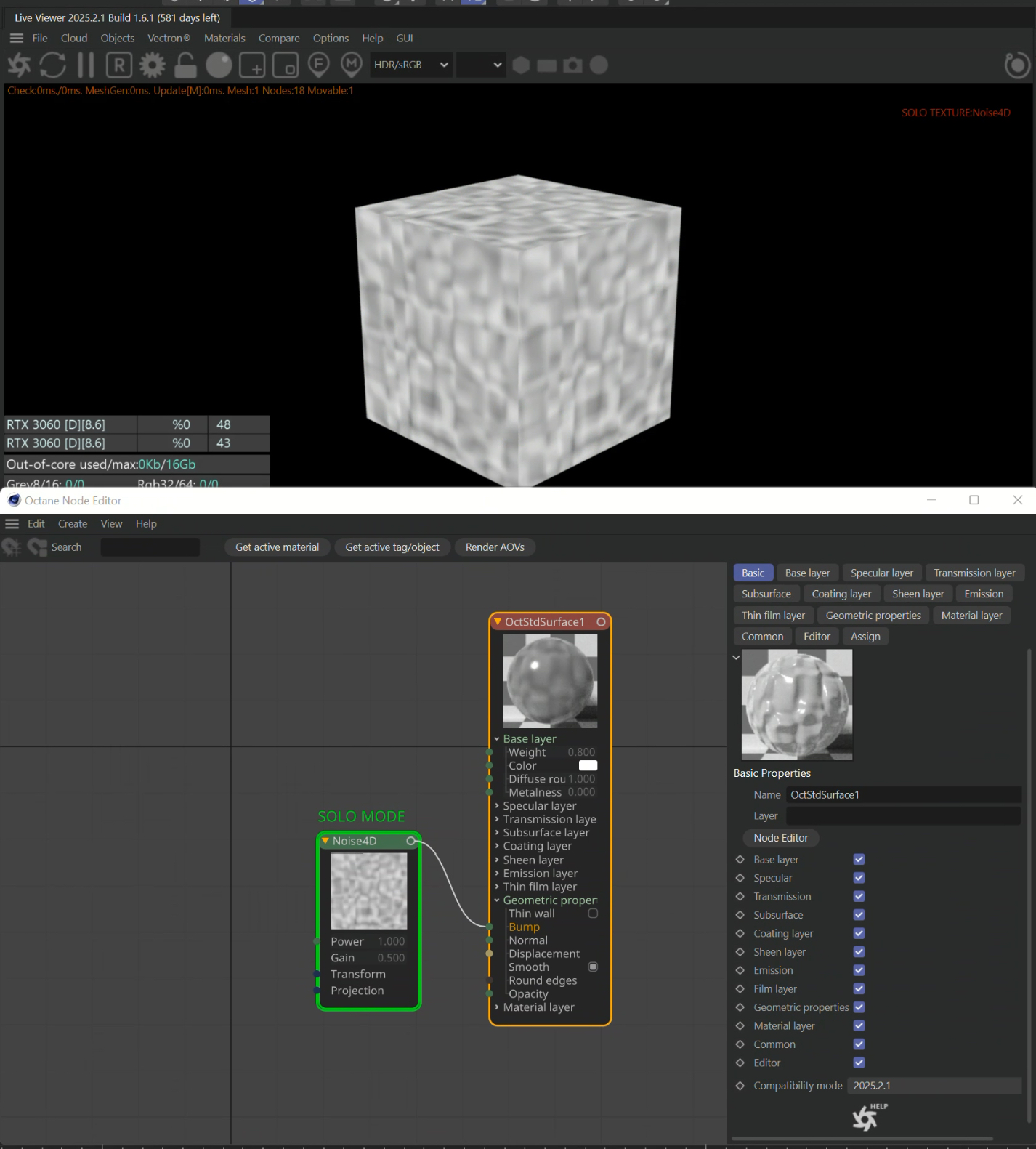

Does anyone else ever have this problem? Half the time solo node works, and the other half, it just creates a black screen. At the moment, I've had two days of nothing but black screens whenever I try to solo a noise node, and creating new scenes and restarting does not fix the problem.
Is there something I could be doing do cause this? I know the bug still exists where if you have two textures open at one time, the noise node will only solo for a few seconds, but this definitely isn't that.

Yep, it's something to do with Standard Surface materials. I already know the material channel is completely broken in this build for Standard Surfaces, but it seems the noise channel is, too?
I just started an old scene, and every the material type performs fine, but standard surfaces fail when trying to solo them. The noise channel will also work immediately when you pump it into another material type.
Is there any timeline on when this and the material channel will be fixed/ Standard Surface is an amazing workflow, but it's completely unusable due to all the bugs.

Please upgrade to 2025.2.1-v1.6.1:
viewtopic.php?t=84942
Solo mode works without issues with Standard Surface material in this version:
