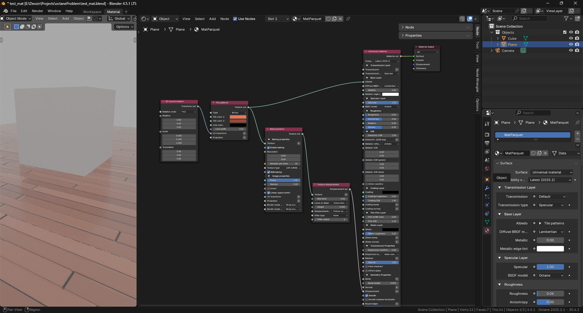

On the plane, I create a new shader, and as the screenshot shows, I'm almost able to create a ground texture with displacement.
My shader
My shader
The problem?
Since I added the "Baking Texture" node, at the slightest change, the Octane server closes and therefore doesn't display any rendering. I should point out that Blender doesn't crash, just the Octane server.

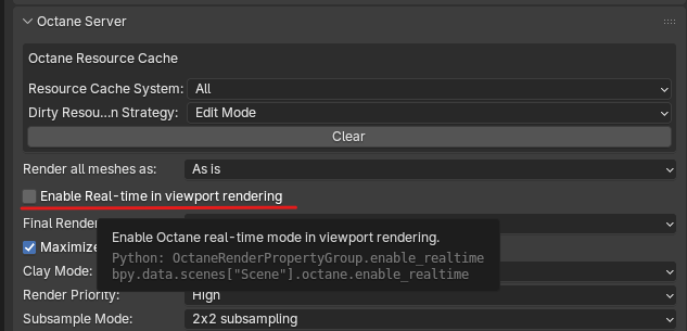

Did you mean this option below or completely turning off rendering?
If you disable the above option rendering will slow down a bit, but not at the point it will not be usable to work with.

No, I was talking about literally stopping live rendering mode while I'm making changes to the shaders.
I have not tested this feature, which is disabled by default on my side.
Once checked, it no longer displays anything in the render window. Maybe I'm using it incorrectly.

Ok, so you are talking about disabling rendering in viewport, not a feature called "Real-time". This feature improves viewport latency, but rendering speed remains similar when it is on. I'm not sure why it is called "Real-time" which is quite misleading.

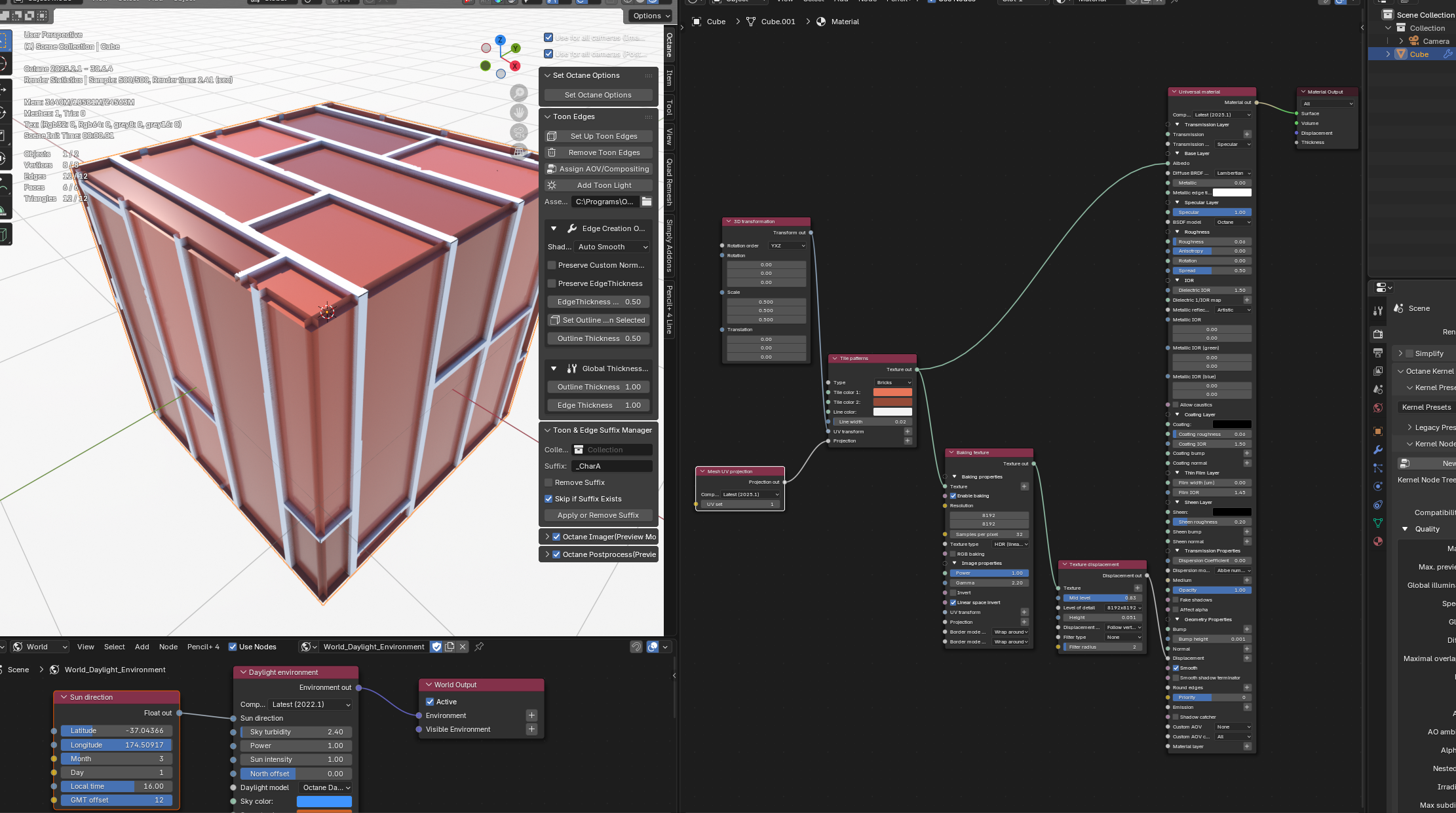

Seems to work fine here.
