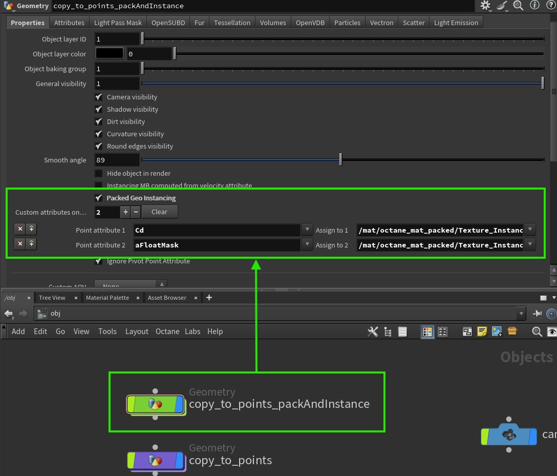

Here is a basic example from 2025.1 Beta:
Attributes.zip
(102.96 KiB) Downloaded 285 times
