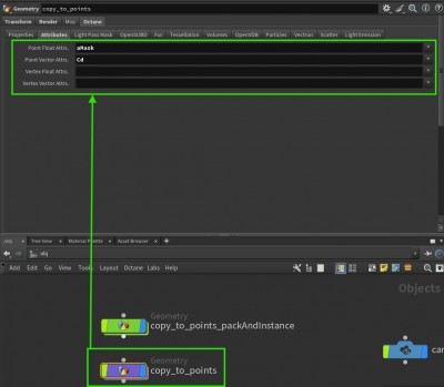

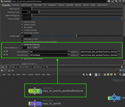

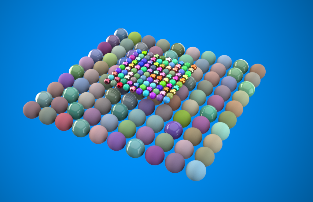

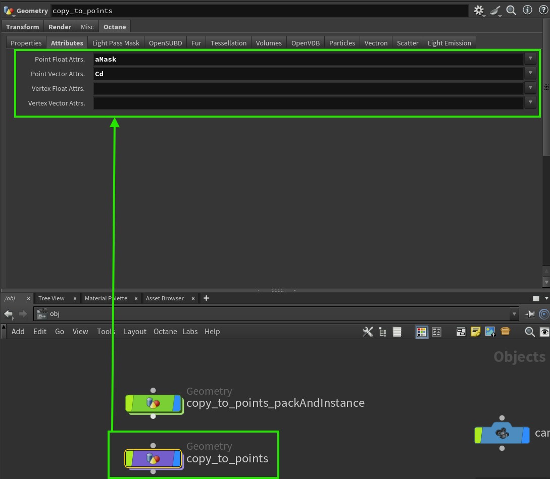

Here is a basic example from 2025.1 Beta:
Currently the documentation is old and a good few things have changed since the plugin itself was taken over. I apologize and do want to update it soon with some proper examples for 2025.1 + but will still take some time.
For now the best place is to ask here or on Slack/Discord channels for what is no longer applicable in the docs. Parm is a term in Houdini and is a parameter in a Node, it isn't a node itself. This is Houdini-wide and not specific to Octane.
We do want to revisit the process at some point to improve the workflow.

About instancing I had found (it took some time) how to setup attributes.
Now I have to see if it is better to use octane scatter node or houdini system and how/if scatter node can manage houdini attributes (N, up, orient, pscale, etc ...).
