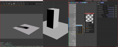

thanks Paul - so close but in this specific case not quite
Polygon Side works but not in Clay render mode
there's also an 'Invert' option to invert the polygons
so it does work but not in Clay mode which of course is what i need right now...
Dingbat
Posts: 180
Joined: Tue Jul 21, 2020 7:49 am
although Polygon Side does work in MODO in clay mode, so maybe it's a bug in AC if it doesn't work there?
Polygon Side works in Colored Clay mode, but not Clay Mode. In theory, the Clay Mode in ArchiCAD should be the same as Modo.
