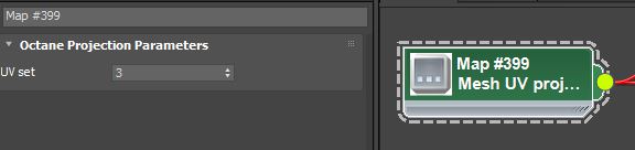

I have a material with a texture with a projection "Mesh UV projection" set to 3.
Each time I open my scene, the projection isn't applied. I need to change the value in the node ( 3 to 2 then 2 to 3 ) then the projection is applied. :evil:

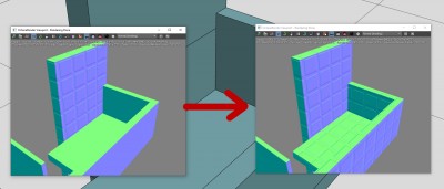

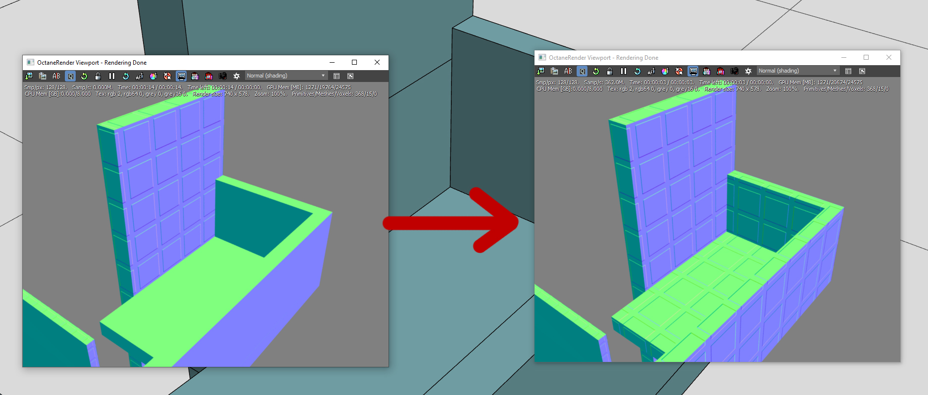

It seems that it is a problem with normal maps.
PBNM1.zip
(342.3 KiB) Downloaded 159 times
when I open the scene, I have the left render, it I change the value of the Map#399 ( from 3 to 2 then 2 to 3 ) I get the render of the right.

Thanks a lot for the scene. I could see the problem.
The issue will be fixed in the next release.
