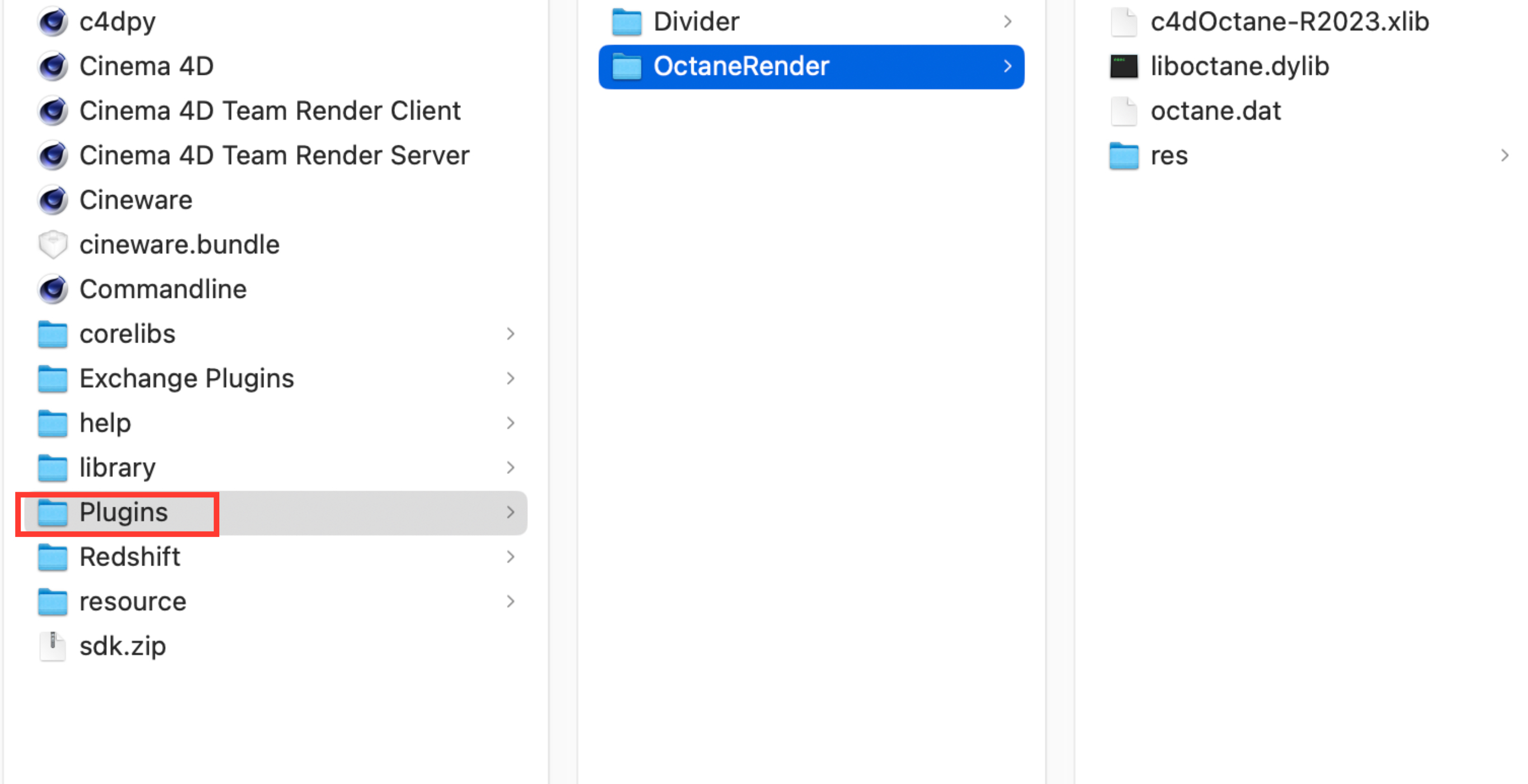

ok, please also share a screenshot like this one, that shows both c4doctane directory opened, and the entire installation path, thanks: ciao,
Beppe

Hi Lars,
ok, please close C4D, then change the name of the folder from "Plugins" to "plugins" in lowercase: ciao,
Beppe
