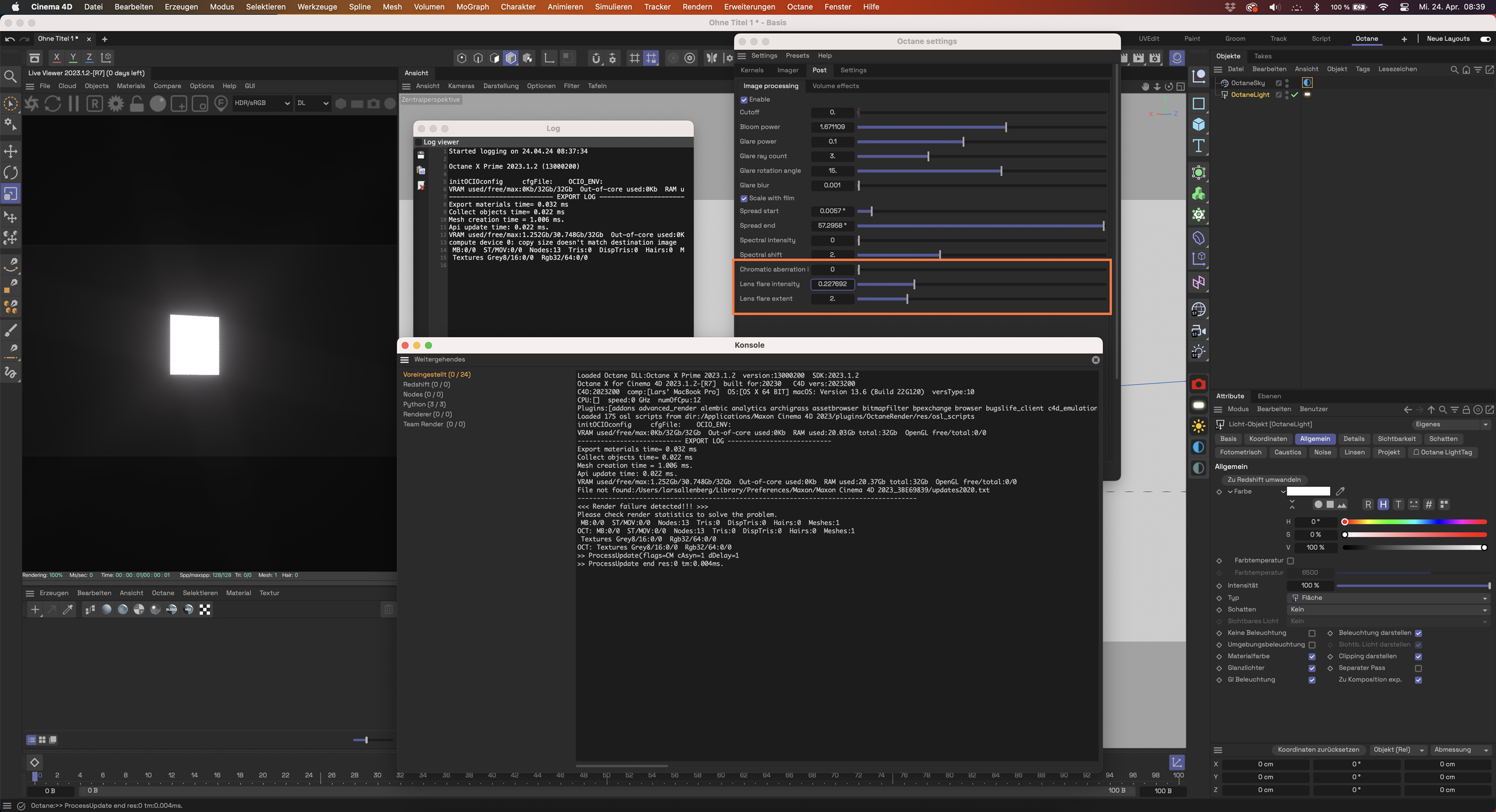

Hi there,
I found that the lens effect features (Chromatic aberration or lens flare intensity) causes a render failure if higher than 0. When I reset it to 0 the LV/Render will work normal again.
Post Processing works normal. Running the latest MacOS Standalone and the latest stable C4D Plugin on my Macbook M2 Max (on 13.6).
Thanks,
Lars

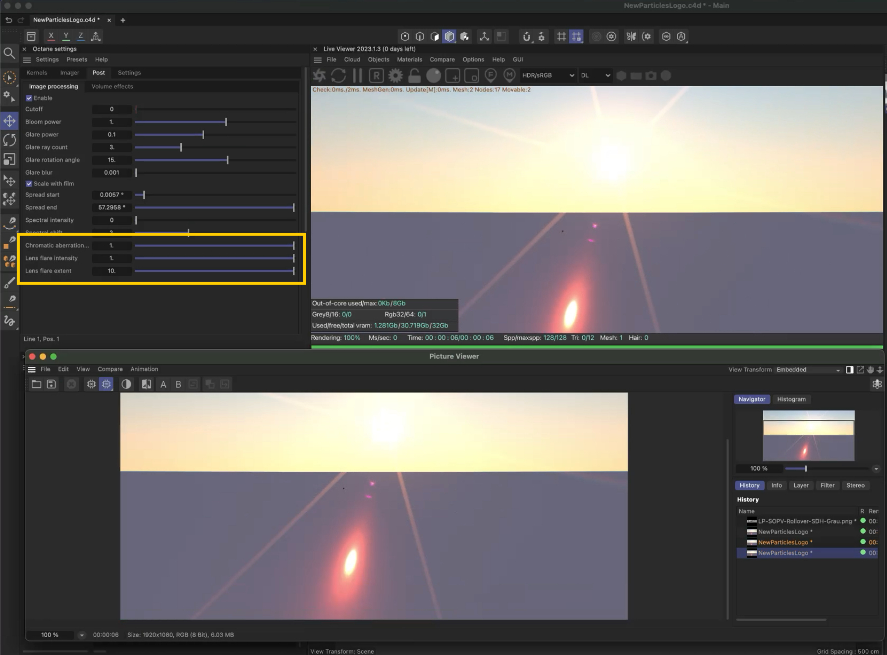

Hi Lars,
sorry but I cannot reproduce the issue here on macOS with latest 2023.1.3 stable version, both Chromatic Aberration and Lens Flare are working as expected in both Live View and Picture Viewer:
Please go to c4d menu Extensions/Console, (Shift+F10), and share a complete screenshot of the panel, or copy paste the default console output in your answer, thanks.

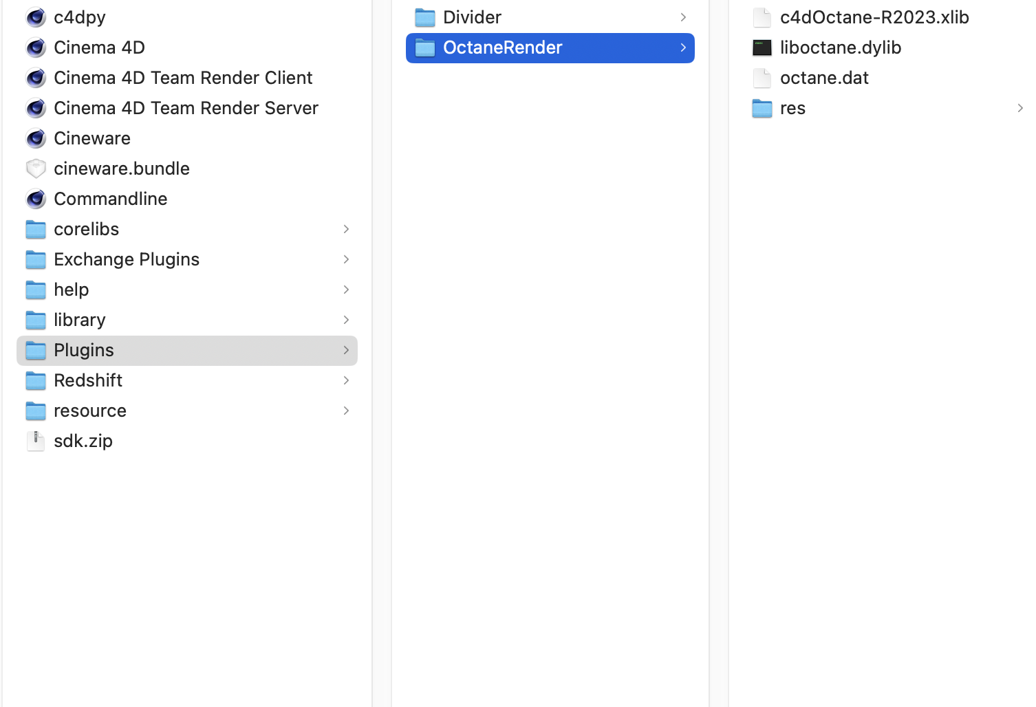

Posts: 10616
Hi Lars,
ok, please also share a screenshot like this one, that shows both c4doctane directory opened, and the entire installation path, thanks:
ciao,
Beppe

Hi Beppe,
this looks pretty much the same. Only difference is I renamed the folder to "OctaneRender" to shorten the long default name in the C4D extensions. But I handled it before like that and lens flare was working.
Best,
Lars

Posts: 10616
Hi Lars,
ok, please close C4D, then change the name of the folder from "Plugins" to "plugins" in lowercase:
ciao,
Beppe
