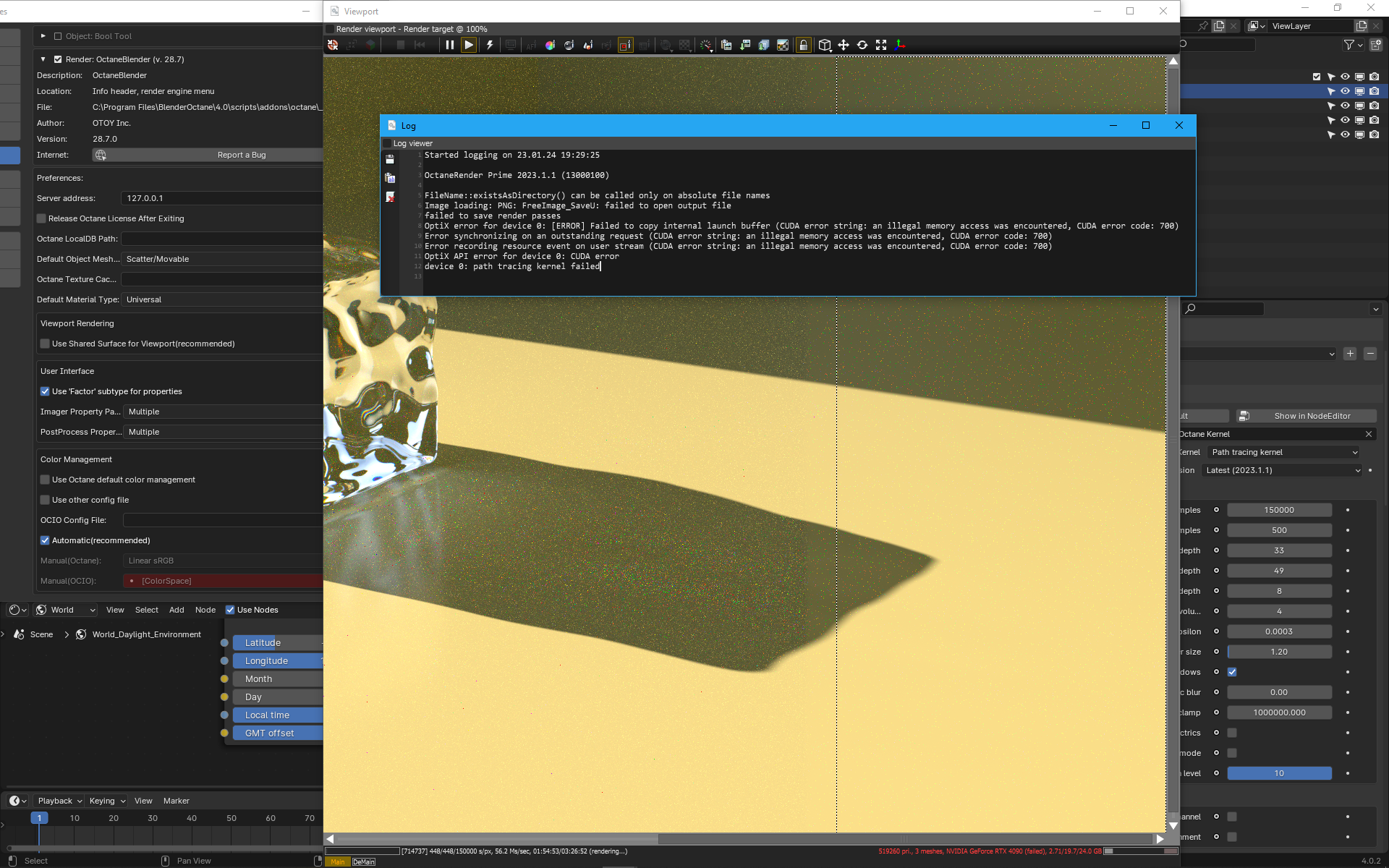

After DDU used and GRD 546.33WHQL driver reinstalled (not then updated), I've installed Blender Octane Edition v28.7 stable and I get 3rd GPU failed with same CUDA code error on today:
-714737 spp of 1M spp with region picked during 1 hour and 54 minutes of total with average 55~56MS/s but can not complete 1st lap of 1M spp.
But I don't reinstall Windows 10 yet. ;)
