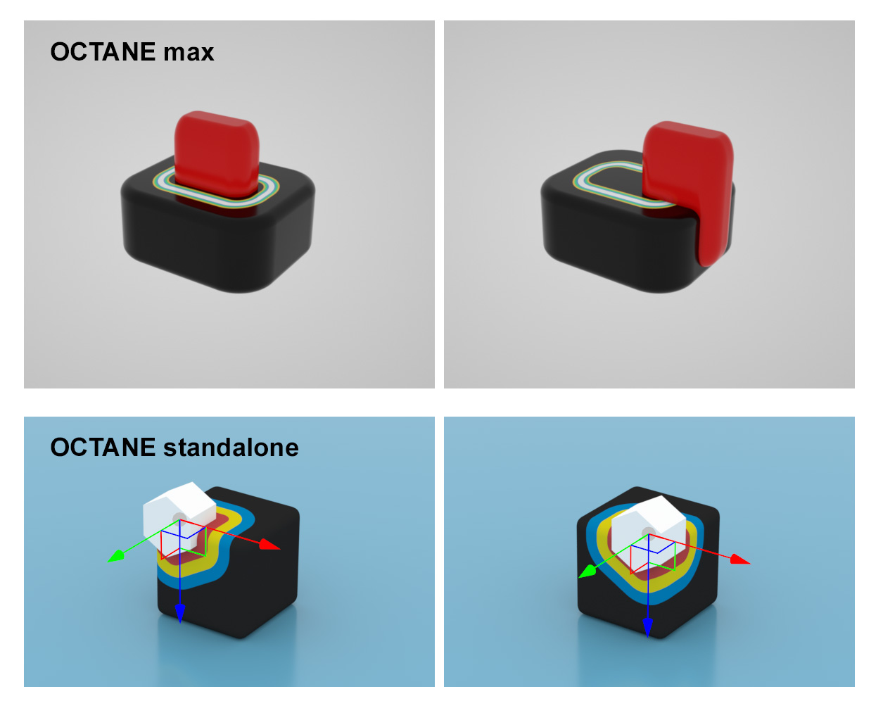

Can somebody explain how to use Shape field with gradient ? I tried, but I can't reproduce the pict.
Gradient is not updated when moving the SDF, not in good place,...

Hi Paride !
Thanks for the file.
So I have always my problem : In standalone the gradient is at the good place and move with the "Core shape SDF" ( named in material editor node )
But not in Max.
Even when I import orbx in max en move the object, the gradient is not updated.
Hope it can be fixed !

Hi HHbomb,
in SA there are two ways to project the shape onto the other object: changing the placement's position or changing the translation of the UVs.
In 3ds Max, currently only UV translation is available.
It could be possible to create a custom Vectron OSL shader that includes a placement option. Alternatively, it's also possible to achieve this through Parameter Wiring, connecting the object's position to UV translation.
The developers will attempt to include the Placement node, along with options for automatic configuration, in an upcoming release.

Hi thank you !
It would be great that such usefull features could work properly in Max !
I vote for a "custom Vectron OSL shader that includes a placement option"
