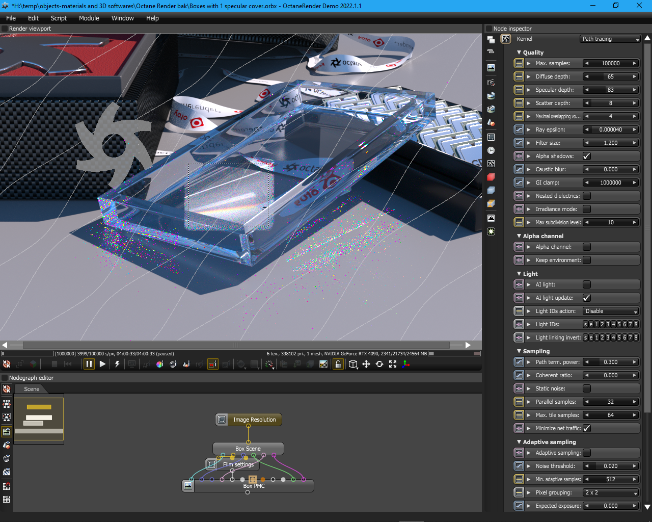

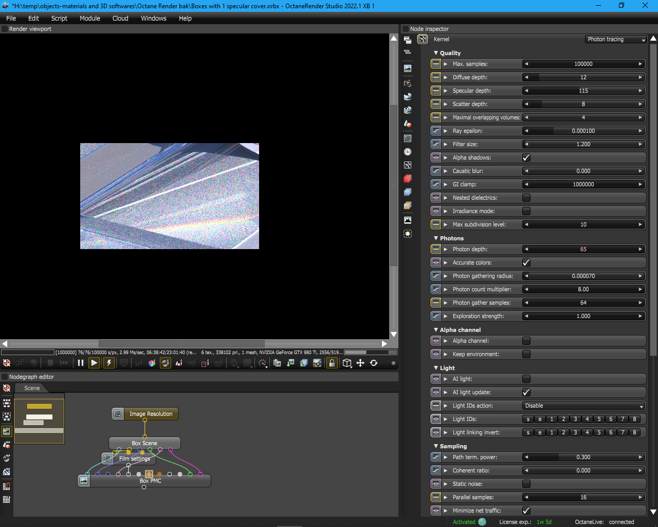

Problems for caustics!??? But I tested 10 laps of 1 MS/px (= total 10 MS/px) and caustics got no any issues at path tracing kernel.
"Box" scene on OR standalone (not OR plugin for Blender):
-- 1 MS/px of region picked during 6h30min at 1680x1050 on my old GTX 980 Ti SC+ at photon tracing kernel (NOTE: PPM method can't render any variable caustics at less than ~0.4 roughness of glossy ground) but brightness increased badly caustics --
-- 10 MS/px of region picked during 2h10min at 1002x602 (due to "demo") on my new RTX 4090 at path tracing kernel --
130min render time_10 laps of 1M spp of single-region picked_OR 2022.1.1 demo.PNG
(Very) Good caustics = caustics little noised despite path tracing kernel. :) :)

If after first MS/px of region picked completed, we pick manually without any reset more region(s) of 1 MS/px at 2 or more laps (means 2 or more MS/px), we get no any issues.
Otherwise more than 1 MS/px of region picked has single lap, this may get any issue. This issue is ABNORMAL.
