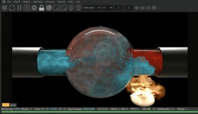

no problems in rendering Pyro sim + extra VDB object here:
What happens if you render the VDB alone?
Is it working correctly?

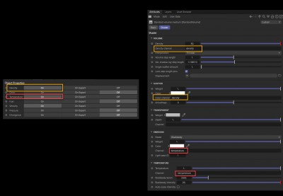

Trick: Let the Pyro calculated a few frames then put the tag. It will create and adjust the Standard Volume for you as your calculated channels. It will find for channel names by automatically

See my settings, using correct channel names and having channels are trick
leave2
Posts: 83
Joined: Sat Jun 18, 2022 9:38 am
Thanks dude, that's sorted out some of the blackness, my only remaining problem is getting it to render.. It shows in the live viewer, but doesn't show up in the picture viewer when I render. Tanks man!
