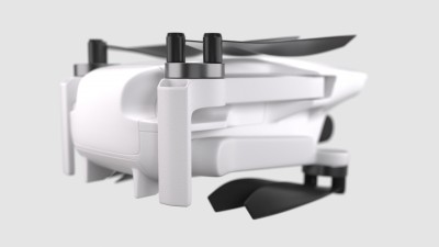

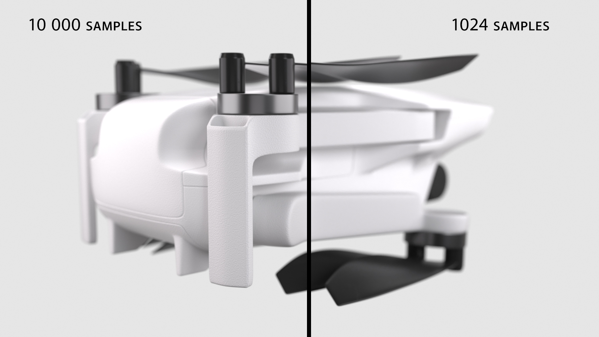

I have an issue that is coming with me from project to project and I don’t know how to solve it. The issue is a noisy blur when you have camera depth of field (see attached, denoiser is turned on). The more depth of field I have, the more noise it has, without the depth of field image is very clean.
I tried all I thought can help and all I found here, and the result is the same…

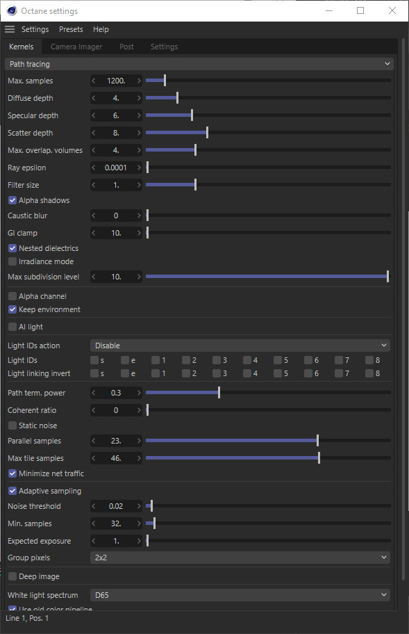

So, here is the list of things I tried:
1. Increase samples. I had 900 samples and tried to increase them to 6000. No changes
2. Adaptive sampling, not a big difference, little better when min samples are lower.
3. Filter size, hot pixel removal also didn’t help.
4. 2x dimensions and then rescale it
5. Direct lightning and Path tracing gave the same result (PMC is taking too much time, I want to do an animation, so 12 minutes per frame is really painful)
I am rendering in 16-bit, EXR Octane. And this situation really upsets me, because I absolutely love this render, am I doing something wrong? I see a lot of octane artists with a beautiful clean depth of field and I don’t see many topics with this problem in the forum. Adding dof in post is not an option, it gives me a bad result, much worse than in octane.
I would be very grateful for ANY suggestions or tips, thank you all

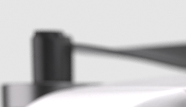

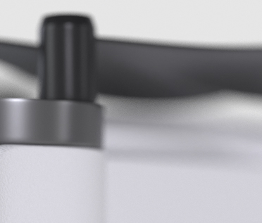

Noise with lower depth of field

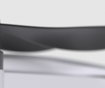

Noise with high depth of field

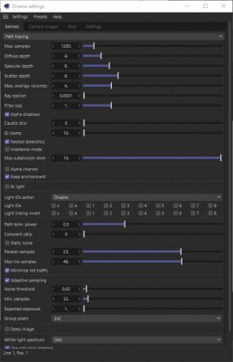

My settings
My settings

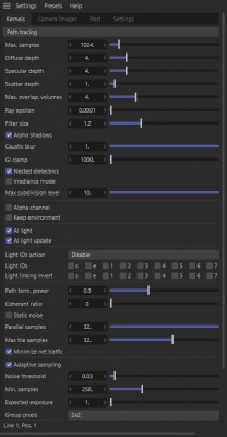

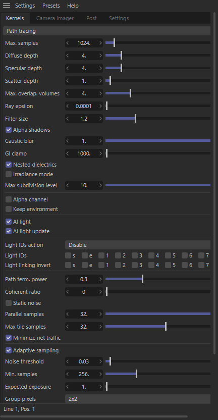

I have tried changing the settings and it seems to me that result is the same. I have tried different materials, with or without roughness (also with very little roughness). The lighting in the scene is very regular, just a simple hdri with very little power, and some area lights also with a small power (because of the size of the drone, it is like 10 cm). Adaptive sampling I also changed according to the noise map.
I also changed parallel samples to maximum and maxed out Caustic Blur. You can see my updated settings attached.
Maybe I'm wrong somewhere, but so far everything I've tried does not bring any changes. Anyway I'm very grateful to any advices
