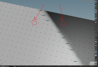

You can't mix two displacement maps using Displacement node. You need to use Vertex Displacement and Vertex Displacement mixer.

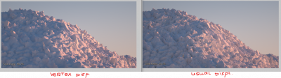

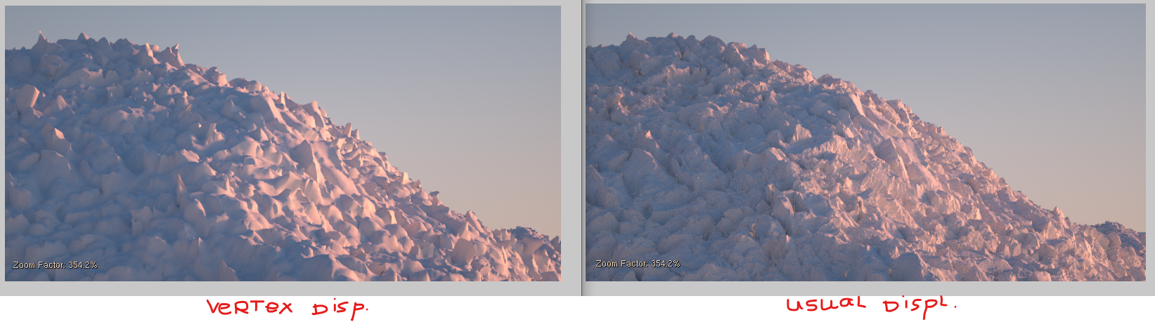

2. It looks like I should subdivide my geometry hugely to get result hires enough which loads GPU a lot. Attaching the comparison between vertex displacement vs. usual displacement.
Just turn on auto-bump and you'll be good. If you need more details, you will have to subdivide the geometry. I suggest to read the manual to learn the differences between the two. https://docs.otoy.com/StandaloneH_STA/S ... cement.htm

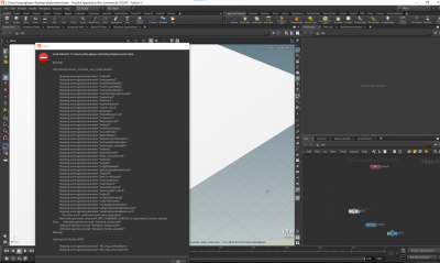

But for some reason the scene opens with errors. Can you please check screen in the attachment?

The scene probably comes from an earlier plugin version. Usually, it is safe to ignore these warnings, but some render target settings could be reset to the default values.

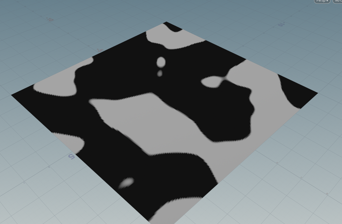

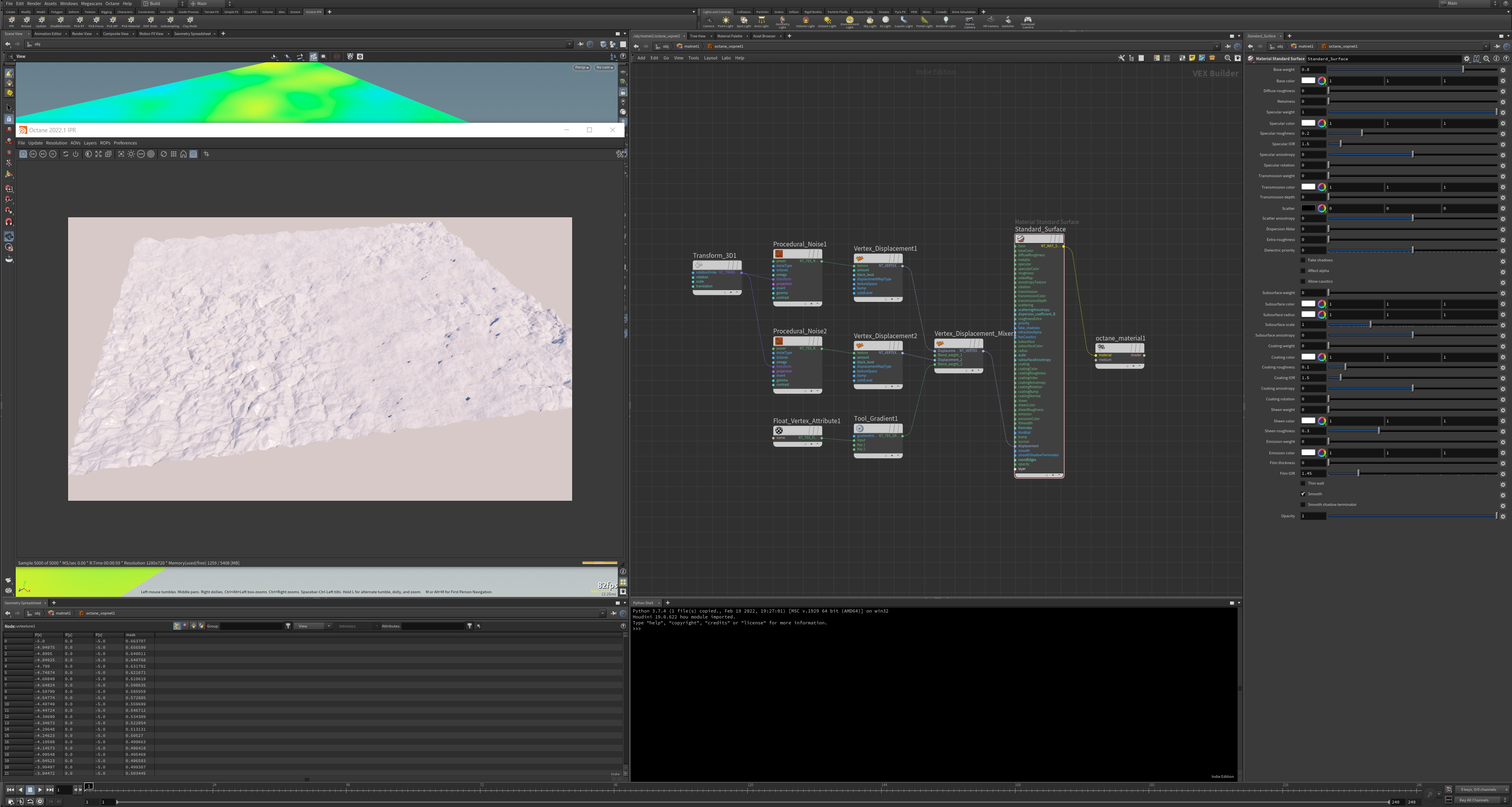

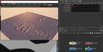

Ok, having downloaded your scene, I did my own tests following your workflow and I still can't understand why it doesn't work for me..
I created Attr. VOP with float attribute cow it has 0 and 1 float values in relevant black/white areas (I double-checked it using visualizers). I plug it to mixing amount and still it doesn't work.. What am I doing wrong?

Upd. Ignore - me stupid. I just forgot to add cow to Octane's attribute field on that Grid's geo.

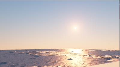

Hmm.. the only problem with this approach though is that now I can't seem to make displacement push the geometry outwards - it's very flat looking like a regular bump now.. Can I ask you to check my simple scene in the attachment please?
Maybe I'm somehow misusing the Gradient node attached to Float Vertex Attr?
Looks more like a bump :/
