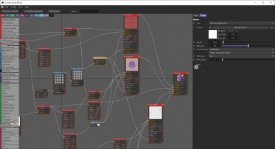

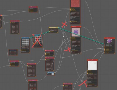

I am using a Layered Material with 3 Submats. I wired a single Displacement node into each of the 3 Mats but it is not recognized by Octane. Displacement is not showing. Is it not working with Layered Mat?
Layered material with displacement?

The Cinema 4D Layered material is not supported. You can use the Composite Material instead, though you would need to add a Bake Image node before the Displacement node to Texture displacement. For vertex displacement, use the Vertex Displacement Mixer node to blend several displacement maps together.
