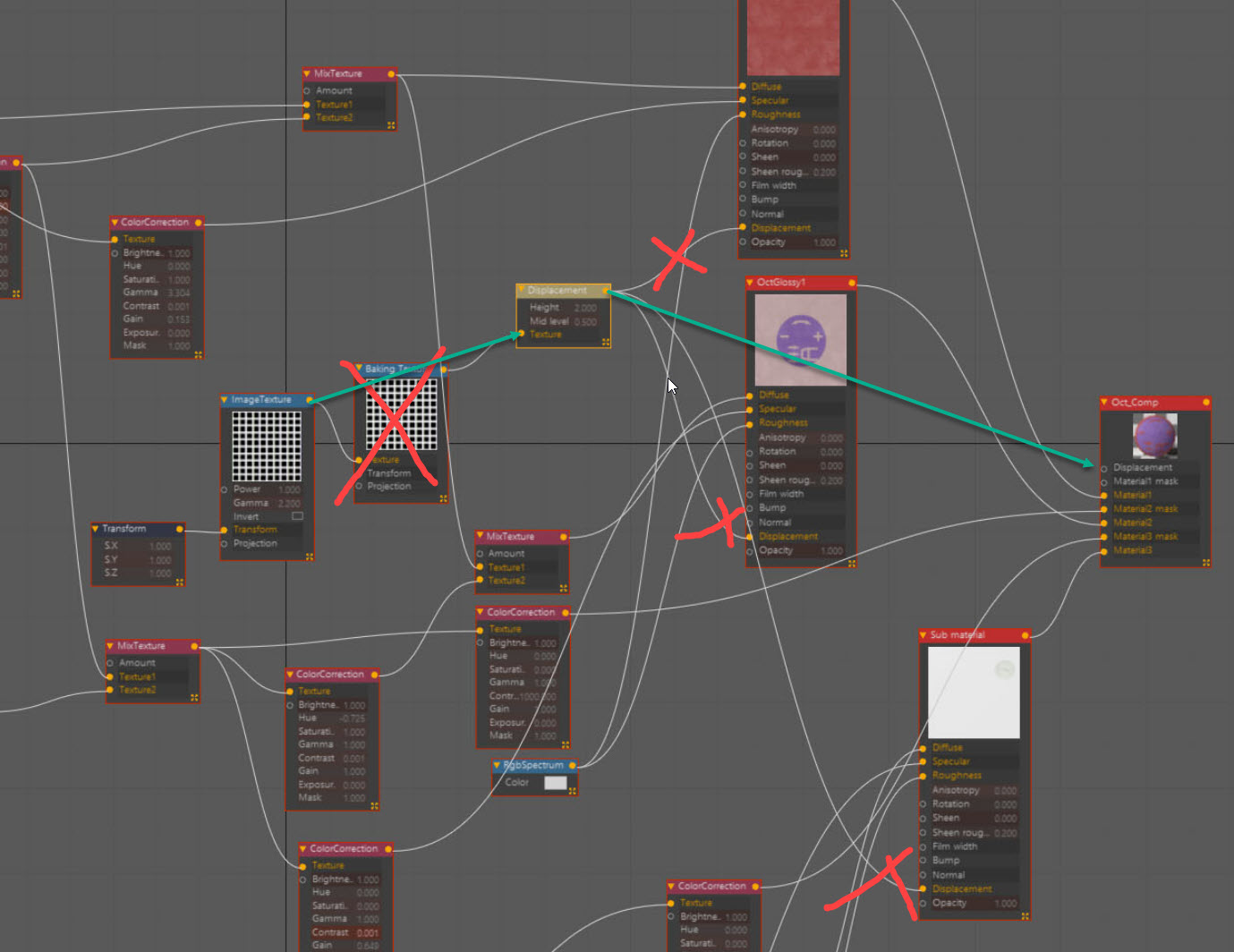

thanks! I use Octane Composite MAterial with 3 Mats. I have Dipsl from Texture wired in all three Mats but it is not working

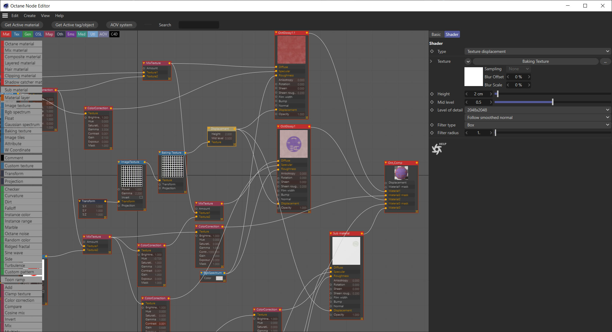

correct usage
