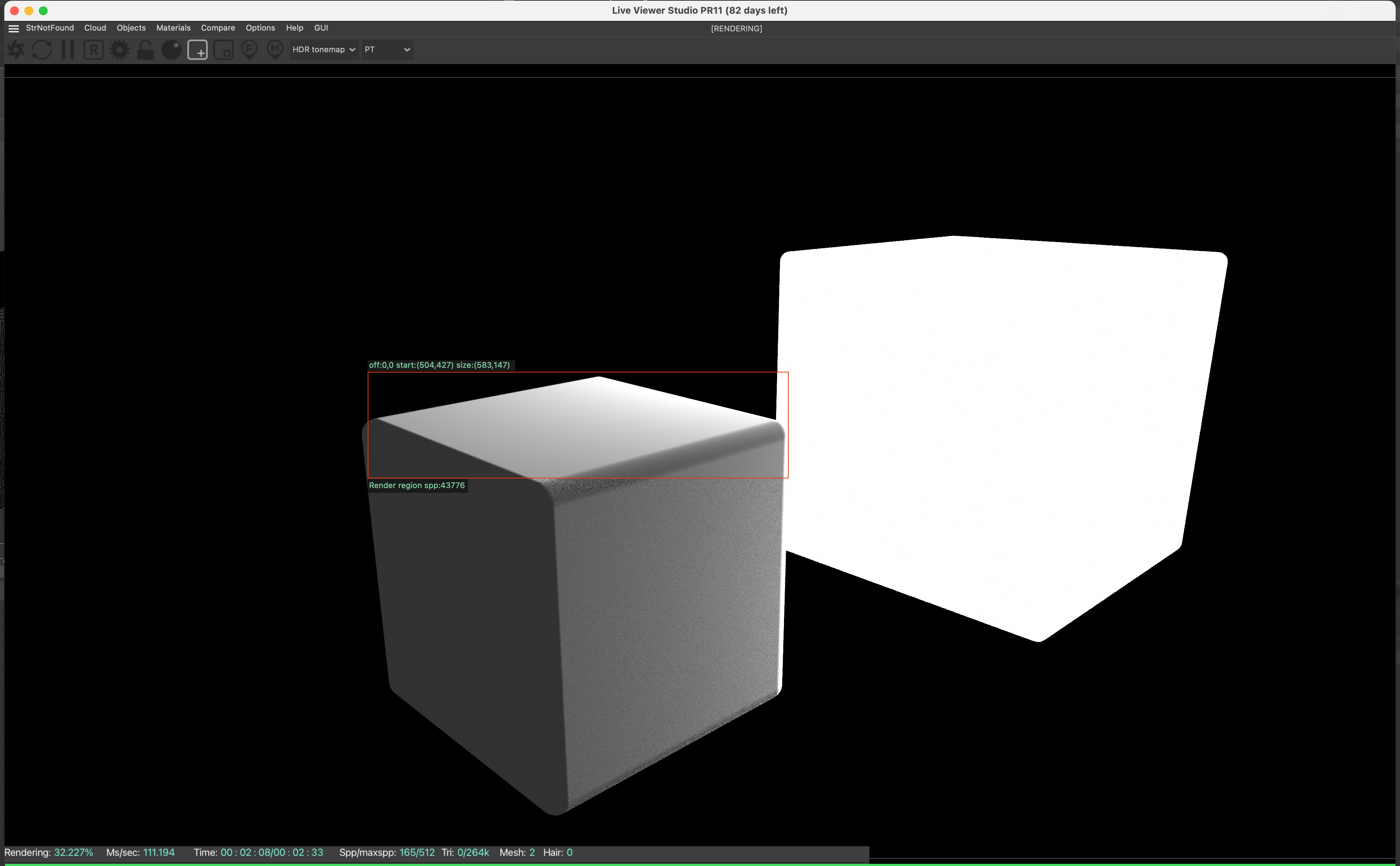

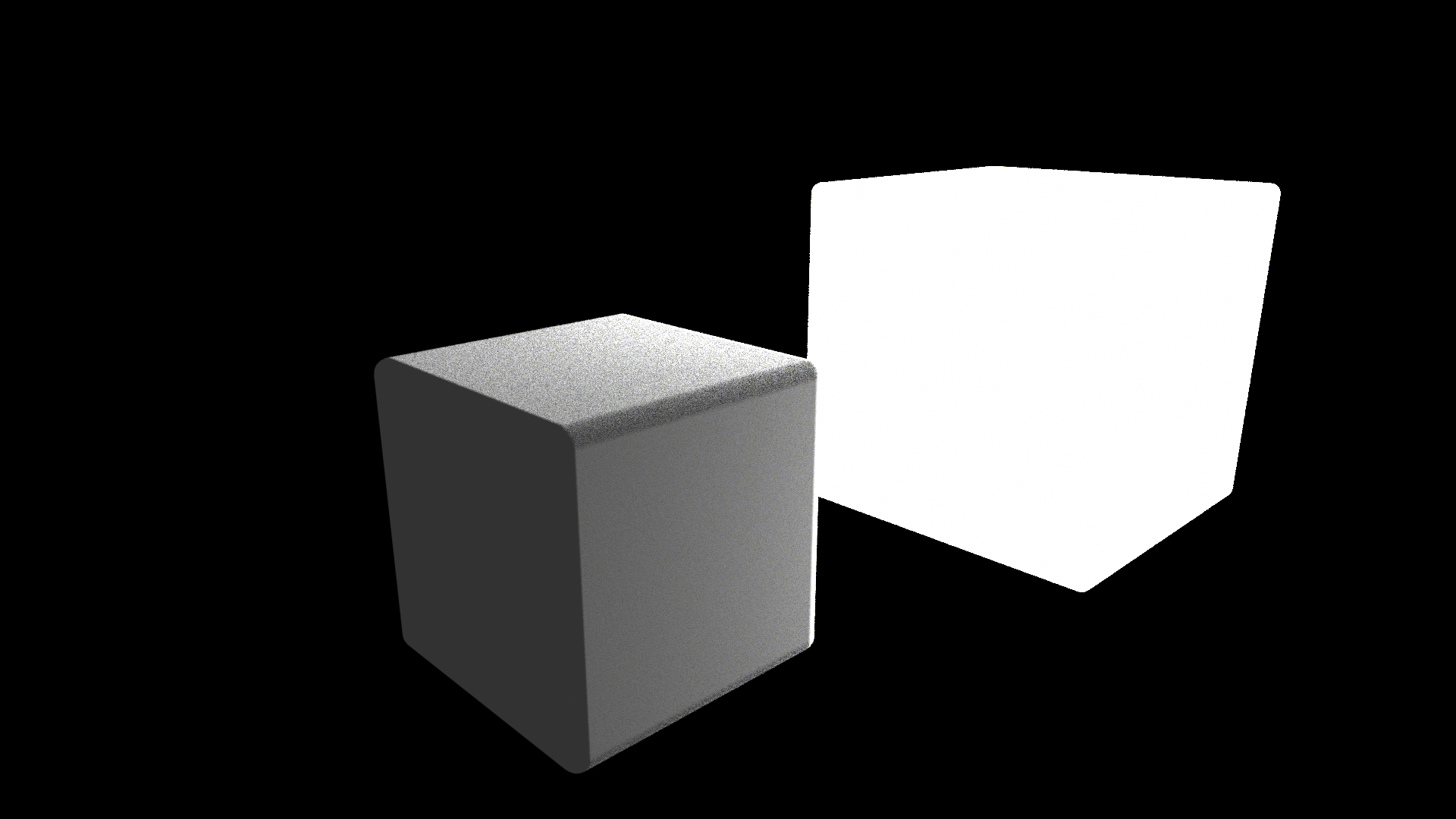

this is odd, I'm getting better results from emissive renders when enabling render region:
This is at 512 samples:
Render
Render
render region
render region
Posts: 16068
Location: Türkiye
no odd, it's not producing or re-rendering the parts. Never stops at max-samples if you could notify. It's just for working on small areas with less time.

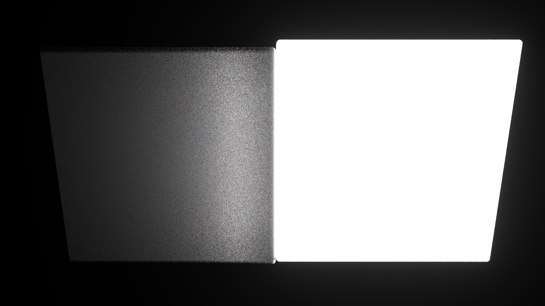

Thanks Elska, I read that and I also tried your tips from this thread where you suggested using a GaussianSpectrum. I still cannot get a acceptable render from 512 samples:
Noise from emitted light
I attached my files in case you want to have a look
LightTest-v01.orbx
Orbx file
(9.66 MiB) Downloaded 118 times
LightTest-v01.c4d.zip
C4D file
(101.9 KiB) Downloaded 125 times

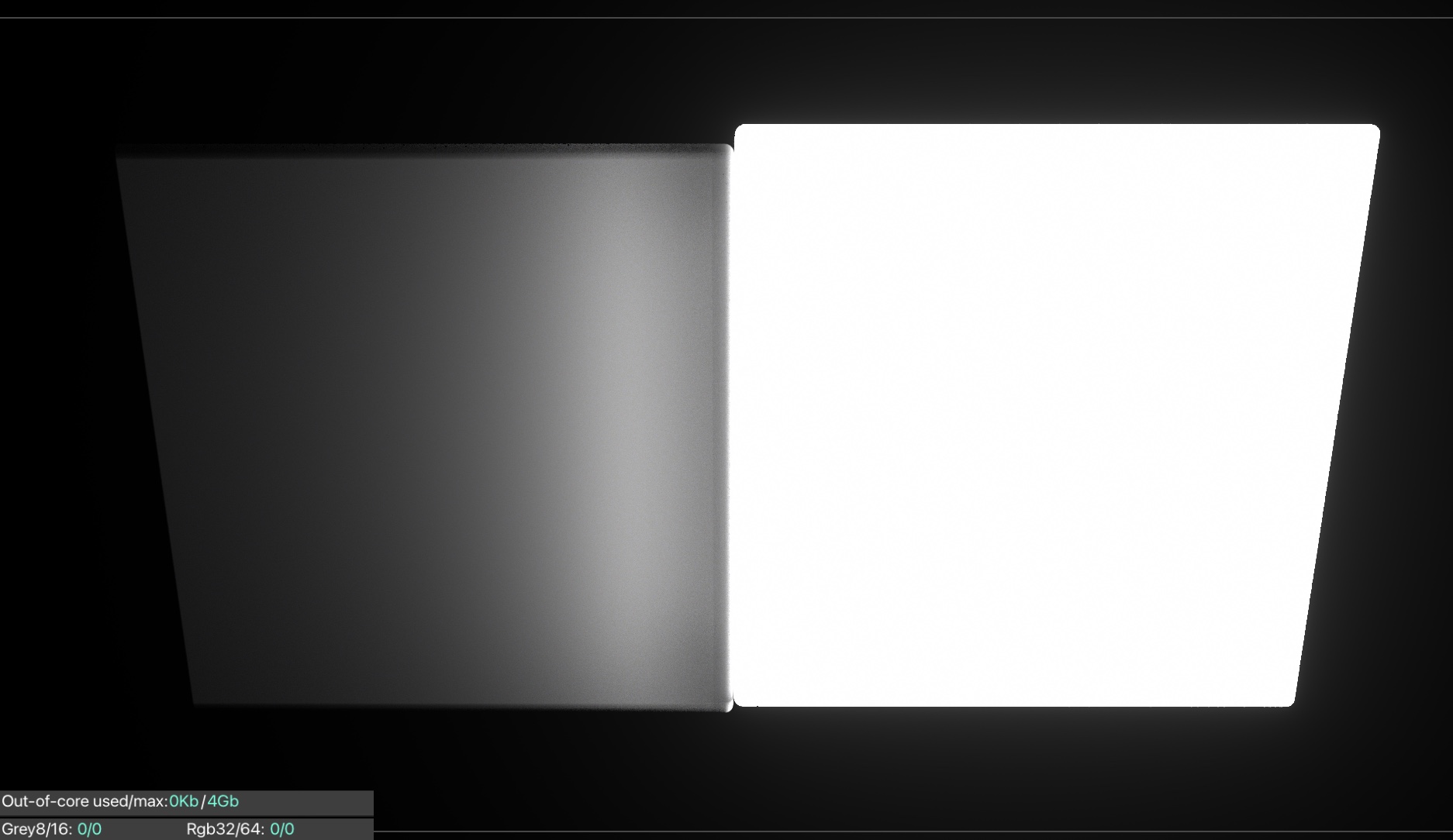

I can get round this using 10,000 samples and adaptive sampling. 42 seconds:
Adaptive sampling. 10,000 samples
LightTest-v02.c4d.zip
(79 KiB) Downloaded 88 times
Surely there is a better way? Unfortunately I don't have the luxury of the denoiser
