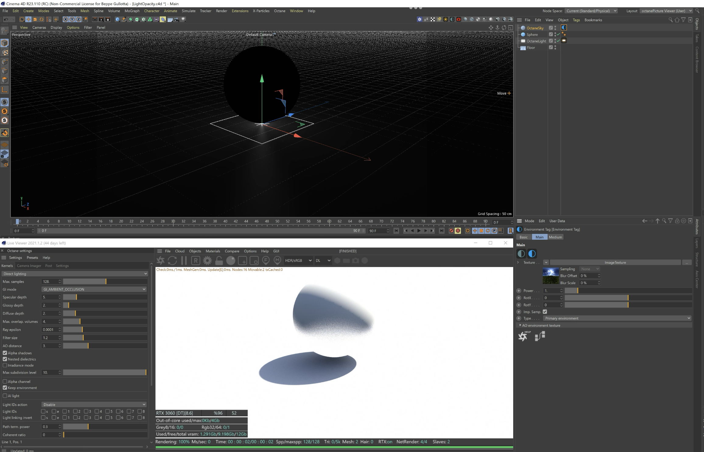

Hello,
Even if I put all options in Octane Area light to be invisible to camera, shadow etc it is still visible to GI generated by Octane Sky for example. If such Area Light plate is 5cm above ground, ground is still obscured by this Area Light even if I disable this Light ID in ground Octane Object Tag. Octane Sky still can't pass throught this Area Light object - there is still visible GI shadow under this light on the ground.
How to make Area Light totally invisible to GI ?

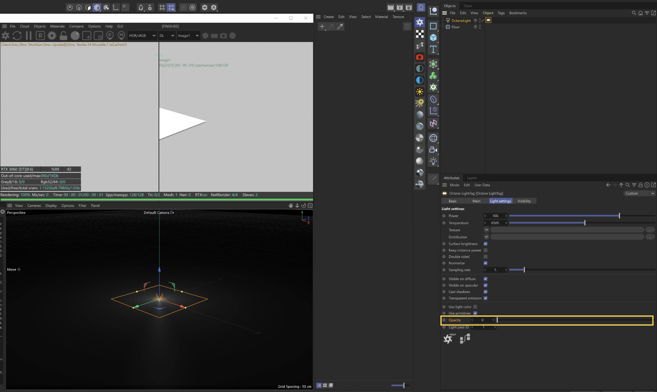

have you tried to set the Opacity to 0 in the Light tag? ciao,
Beppe
Yes but after that lighting from that light disapear too

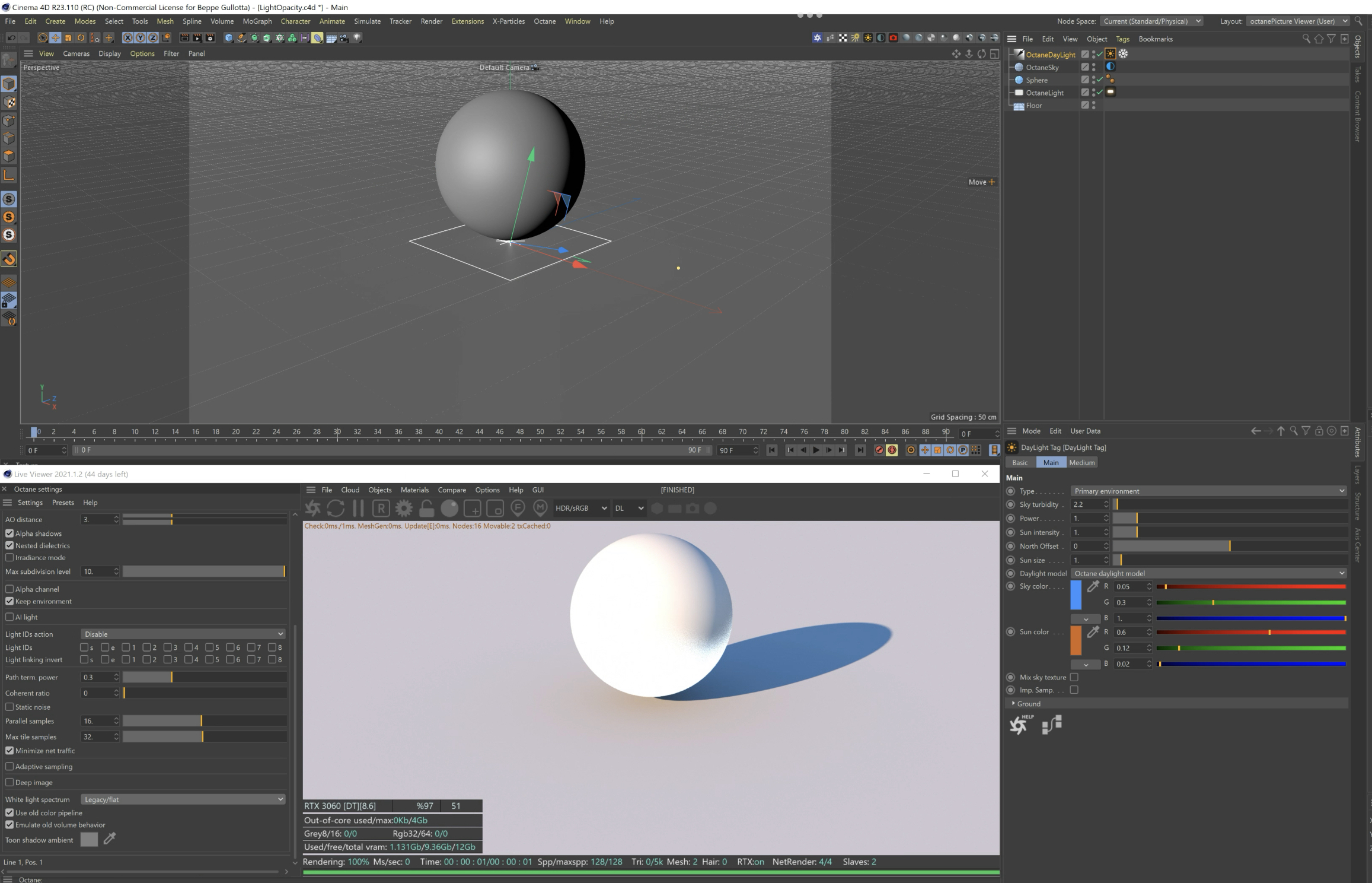

you dont have Octane Sky in scene. If you will have it - you will have dark area under area light
Or light from that area light is gone
Architectural Visualizations http://www.archviz-4d.studio
Again, are you sure?

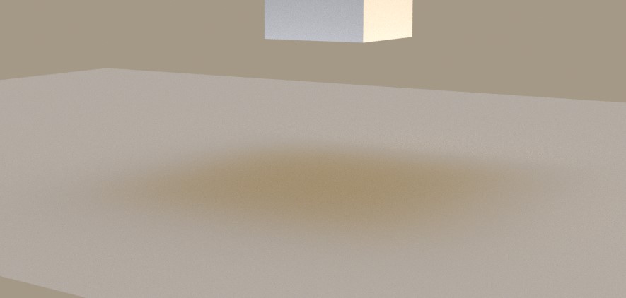

there is still indirect light shadow under area light

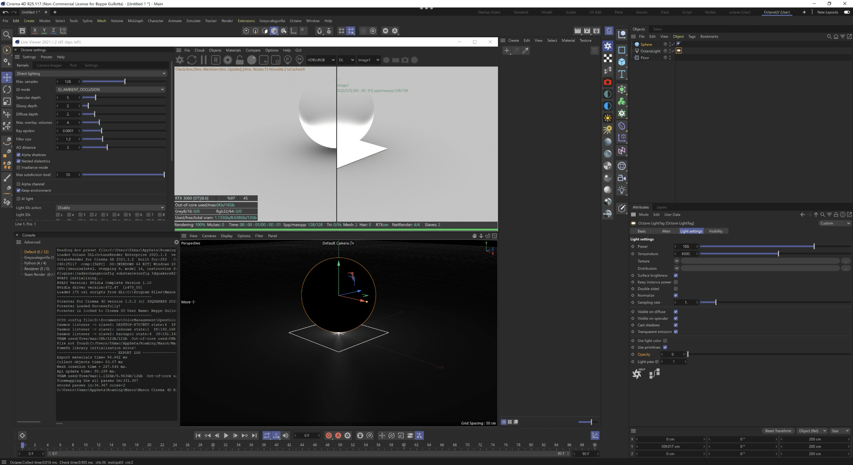

file
If you turn off opacity lighting from light is gone
- Attachments
- area.zip
- (50.68 KiB) Downloaded 78 times
ok it works as you said but with transparent emission turned on which I have disabled. Thank you !
