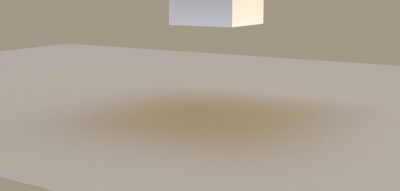

there is still indirect light shadow under area light
