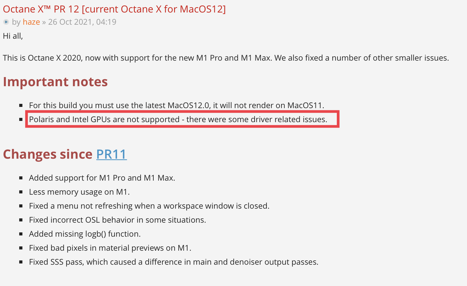

Does this mean I don't have enough RAM? or some file is missing in my computer? How can I fix this problem?
Thank you!
Posts: 10575
which exact model of GPU do you have in your Mac?
Unfortunately old AMD GPUs and Intel GPUs are not supported anymore in new OctaneX PR12/13 for macOS 12 Monterey - there were some Apple Metal driver related issues.
Only AMD Vega, Navi, Big Navi GPUs, or Apple Silicon M1, are supported in macOS 12 Monterey.

I ran into something similar a while back, and in my case it turned out not to be Octane itself but a mix of GPU/driver compatibility and plugins. A couple of things you might want to check:
GPU support on macOS Monterey+: As Beppe mentioned, OctaneX PR12/13 dropped support for older AMD/Intel GPUs. If you’re on macOS 12 and not running Vega/Navi/Big Navi or Apple Silicon, it will just fail to initialize (black screen every time).
FumeFX / plugin errors: I noticed in your log it throws a FumeFX library initialisation error!. I once had the same type of error in Cinema 4D, and the fix was just updating the plugin—black screen went away after that.
Remote connections: If you’re testing over VNC, you might also hit black screens because of CUDA/Metal display issues. Switching to TeamViewer or Splashtop solved it for me.
If none of that helps, double-check the GPU/driver + OctaneX version combo. The render device log line you posted (failed to initialize render thread 0x7fdc09784250) is almost always a driver/GPU mismatch.
