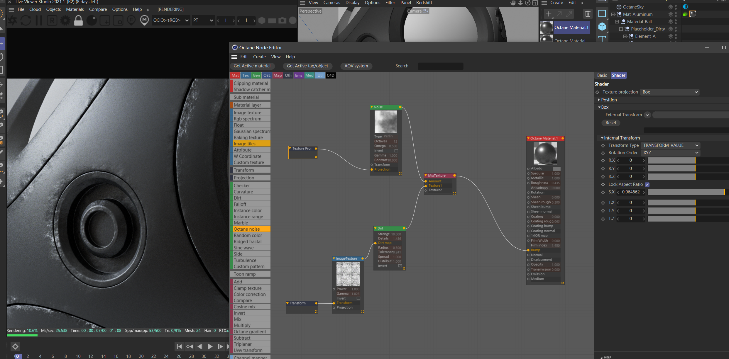

Friends, when I am in the 2020.2.3-r3 version, I can use dirt to link bump directly, but it seems to be invalid in the new version。。
The version I am currentlyusing is 2021.1.2
At present, I can only use the above method to make dirt take effect on bump

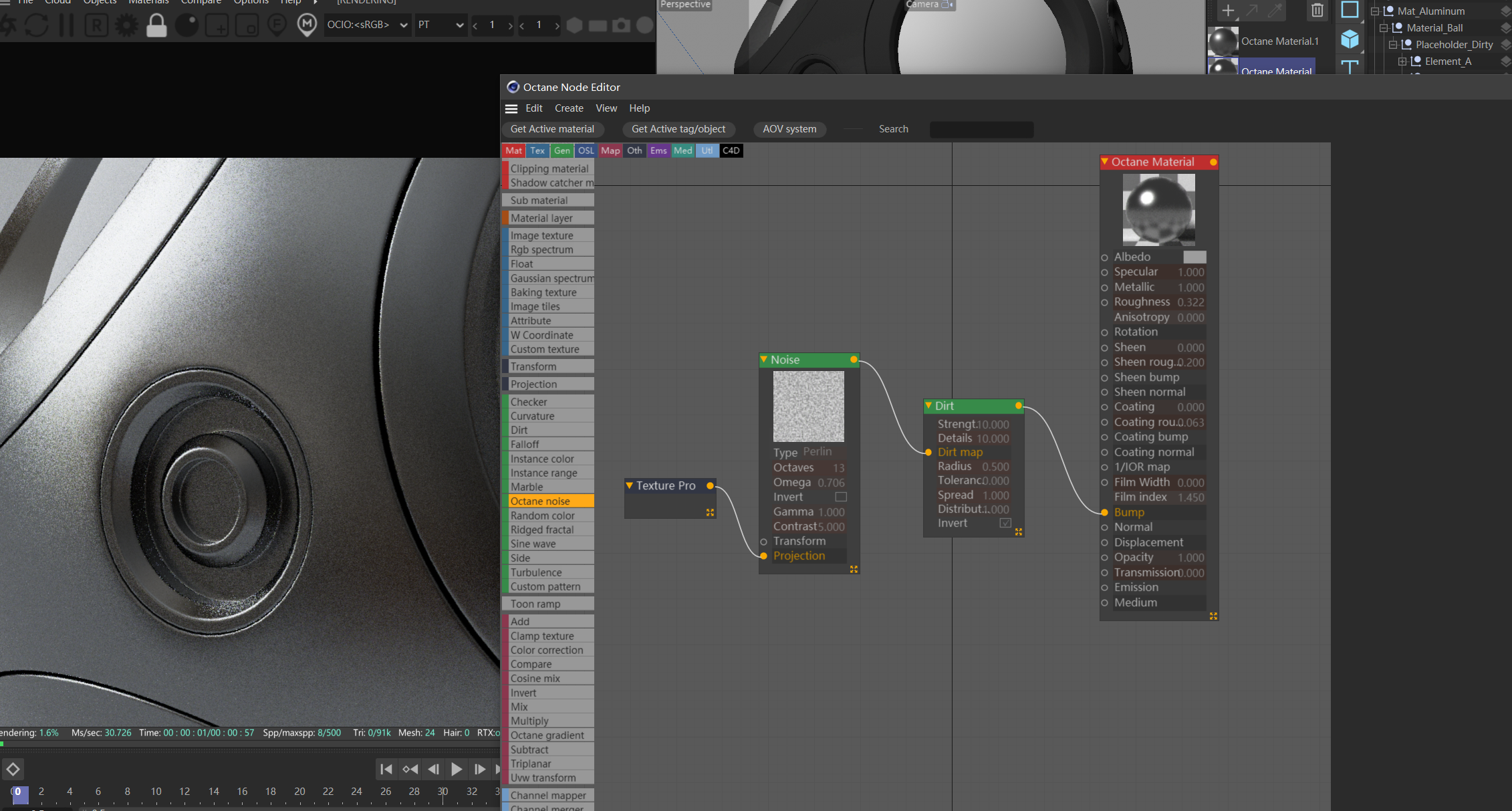

It's working here in latest build. Have you tried that?

Sorry, I didn't understand too much.
Do you mean to connect the dirt to the normal?
Posts: 16068
Location: Türkiye
What you said of else you can connect it to bump and normal

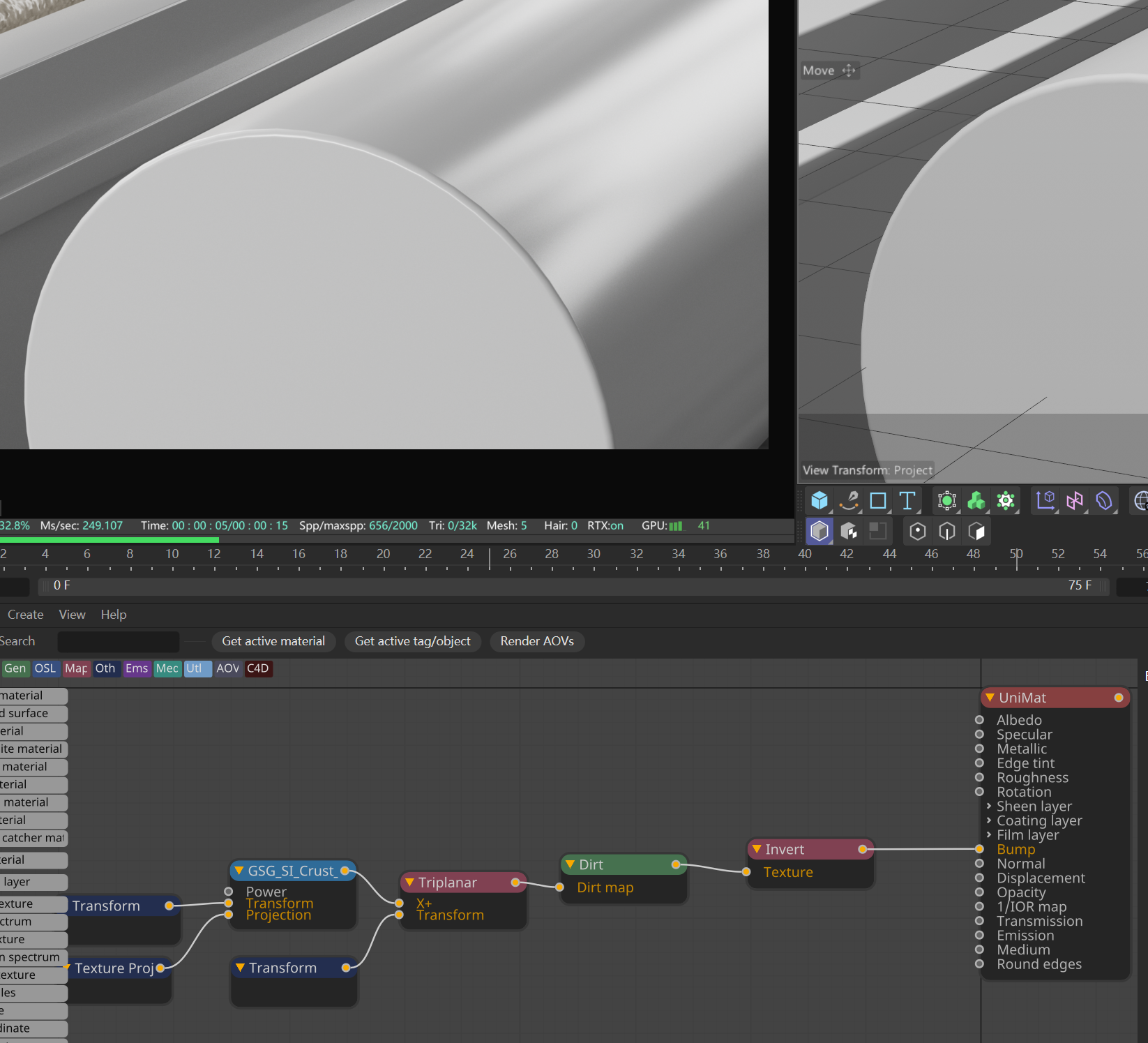

I think image nr. 2 should have worn edges?! Should it work?
see this, there should be a bump on the edges right? but is not.

There is some discussion about this over on the 2022 plugin thread. I use Dirt to drive Bump regularly, but I think I always have it running through a few other nodes along the way. I wouldn't be surprised if Bump doesn't like the direct output of the Dirt node. I shared a simple sample here:
viewtopic.php?f=85&t=80831&p=422825&hil ... mp#p422825

I've seen replies, dirt and tex multiply and then connecting to bump is useful, but what I asked is that dirt connecting to bump is completely useless when there is a map as dirt map
