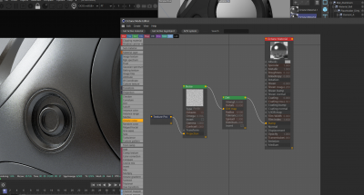

Friends, when I am in the 2020.2.3-r3 version, I can use dirt to link bump directly, but it seems to be invalid in the new version。。
The version I am currentlyusing is 2021.1.2
At present, I can only use the above method to make dirt take effect on bump

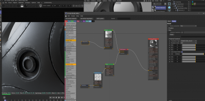

It's working here in latest build. Have you tried that?
2021-12-18_16-39-32.mp4
(1.58 MiB) Downloaded 3366 times

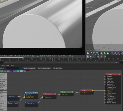

I think image nr. 2 should have worn edges?! Should it work?
see this, there should be a bump on the edges right? but is not.
2022.1.1 R2

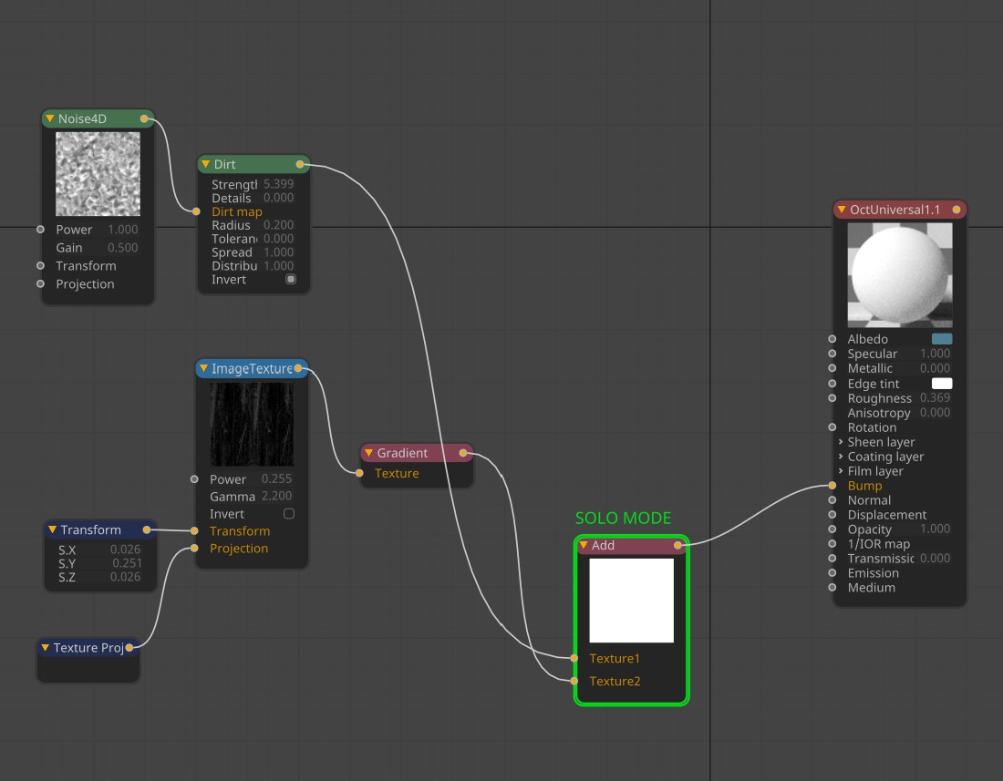

There is some discussion about this over on the 2022 plugin thread. I use Dirt to drive Bump regularly, but I think I always have it running through a few other nodes along the way. I wouldn't be surprised if Bump doesn't like the direct output of the Dirt node. I shared a simple sample here:
viewtopic.php?f=85&t=80831&p=422825&hil ... mp#p422825

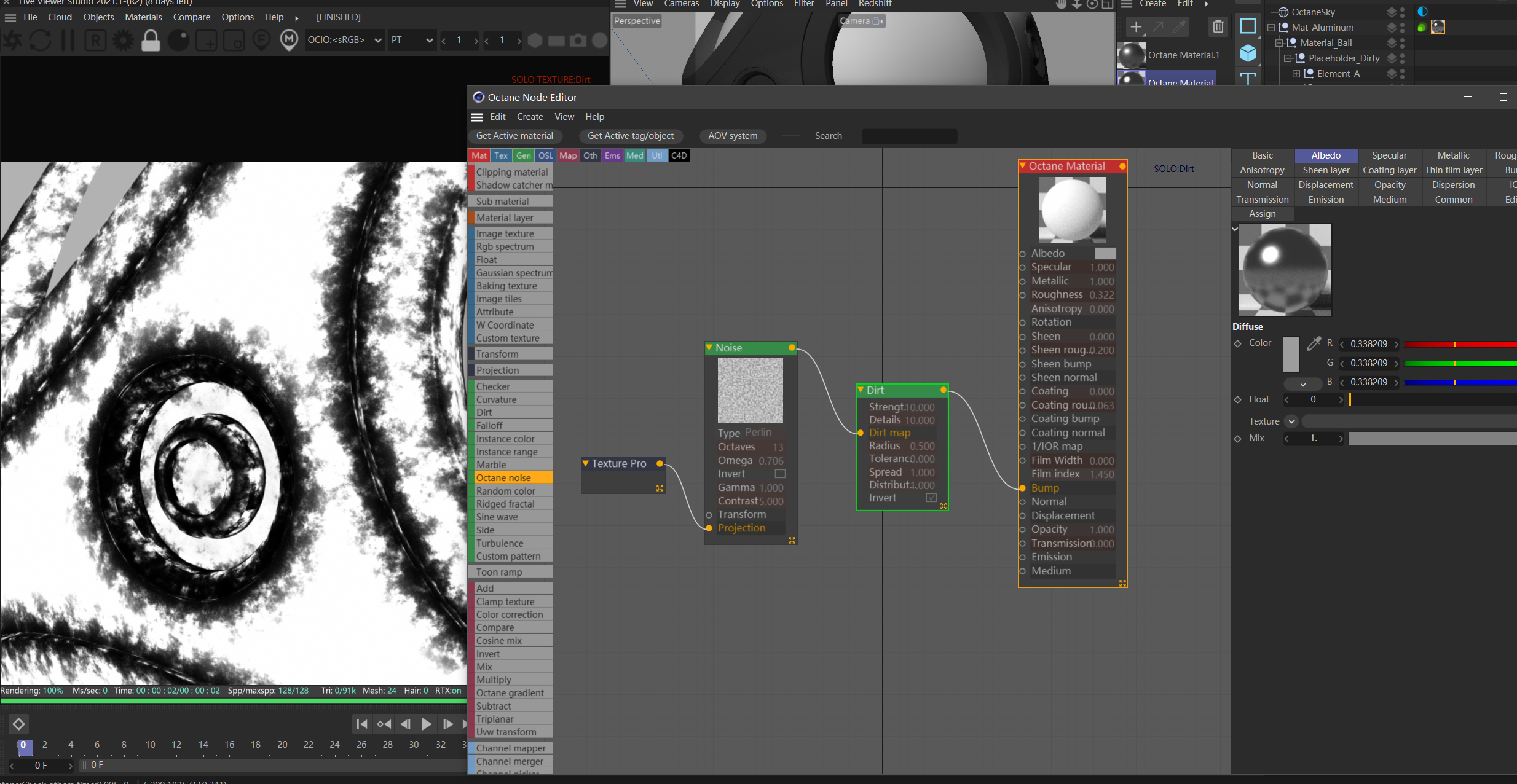

Now it's version 2023
Could someone answer why tex connected to dirt node can't be used on bump

I've seen replies, dirt and tex multiply and then connecting to bump is useful, but what I asked is that dirt connecting to bump is completely useless when there is a map as dirt map
