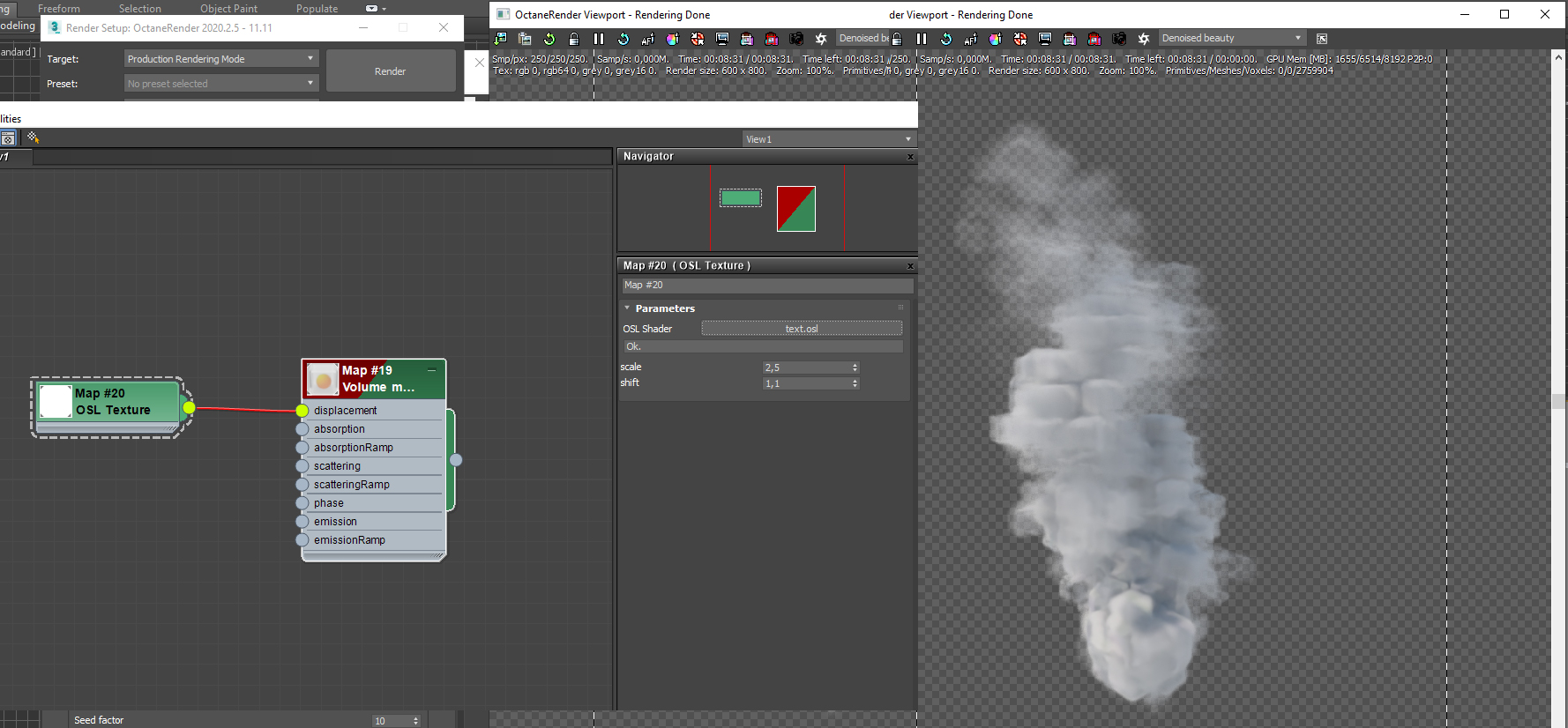

Hi bakanopower,
displacement position option works like in Octane for C4D so you can use the OSL scripts stored in C4D in 3dsMax as well.
Regards
Paride

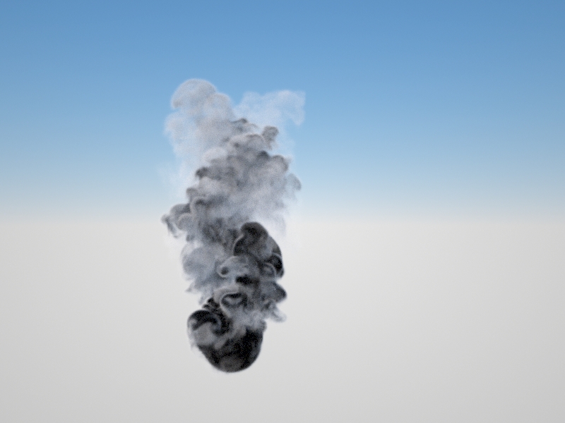

May I ask what version of max you are using?Because when I open this file, my 3dsmax prompts me that the version is too low.
In addition, when I render VDB file, there will always be black shadows in it. Is it wrong where I set it up?
And can I convert the object to VDB in 3dsmax? Like in the first picture.

Hi bakanopower,
please try my updated sample, using Octane for 3dsMax 2020.2.5 11.11
3dsmax does not natively create .vdb, you need plugins like PhonixFD.
Regards
Paride
Regards
Paride
