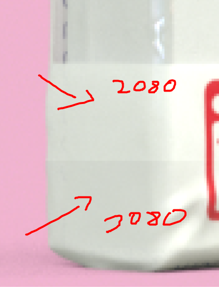

here is the difference between these two card types.
Its the same material, I masked out in AE to see the difference.
Also attached is a quick render with the flickering using all 4 cards.
Look at the pot.
Right now I cant render any scene with motion Blur using all cards together.
